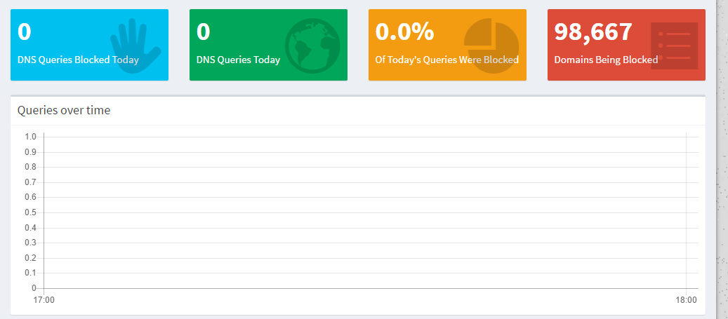

yes, i have a custom page calling the API. I have fixed that error. both my custom page and the admin console show no data. here's the screenshot:

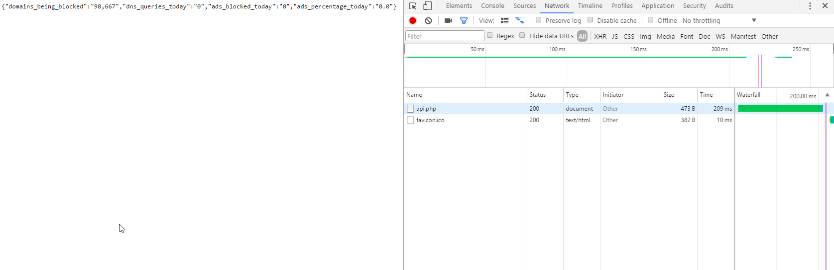

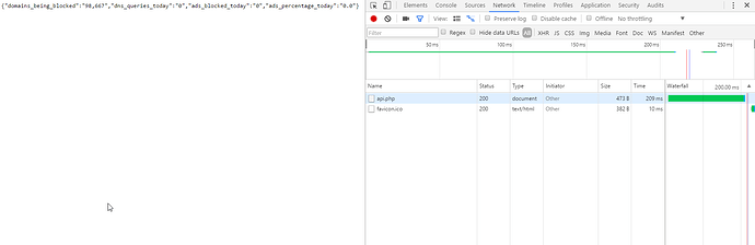

What headers do you get when looking at the API requests in the browser's network dev tool tab?
I'm not sure if I get you correctly, Is this what you need?

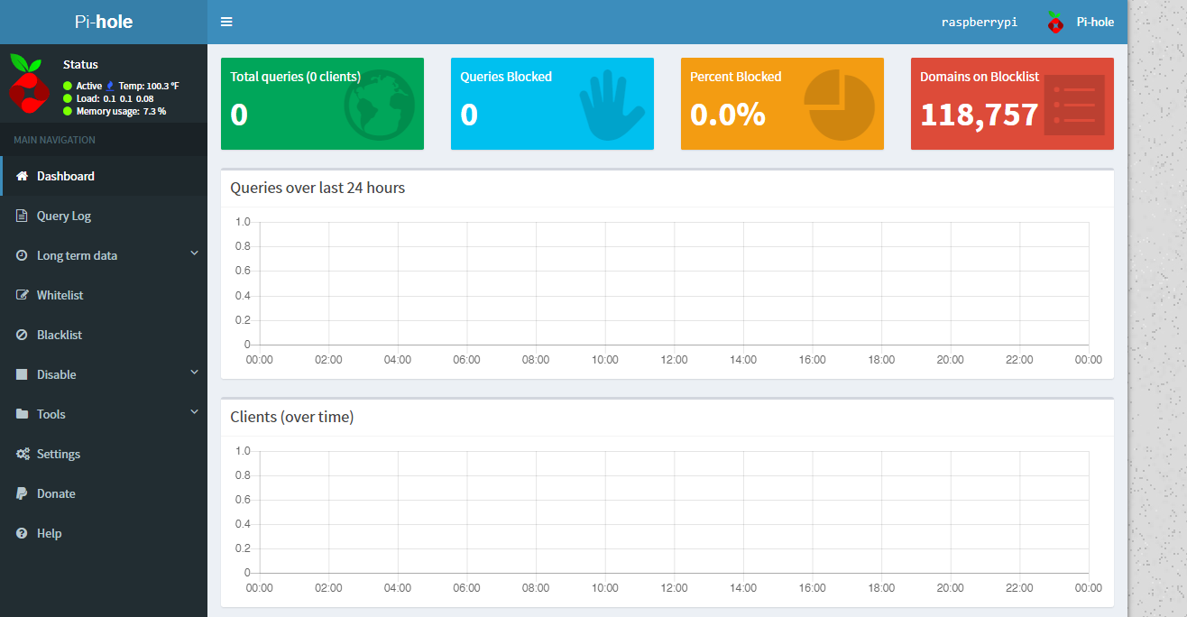

I suddenly had the same issue this morning, as the system was fine as if last night. Please see attached screenshot. I have a monitor tailing the pihole's log and it is processing queries, bu there is no data in the Web UI at all. Please keep in mind I am not a Linux programmer or user (noob). Strange, as it appears to be blocking and forwarding. I have flushed browser cache.
