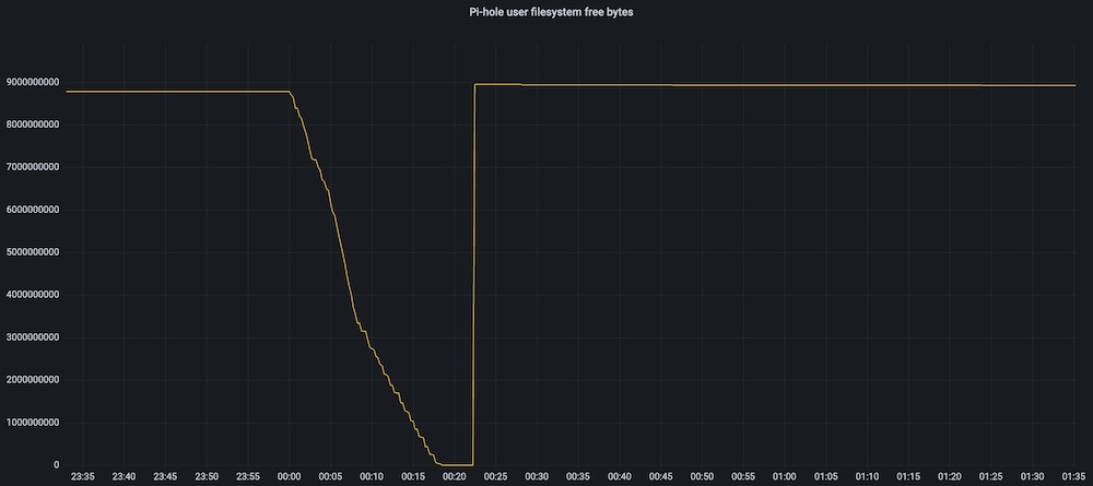

Nightly disk space shortage
The issue I am facing:
I noticed this by visiting http://pi.hole/admin/messages.php
There are a pair of messages generated every night
Disk shortage (`/etc/pihole/pihole-FTL.db`) ahead: **96% used**
/etc/pihole: 30.0GB used, 31.1GB total
Disk shortage (`/var/log/pihole-FTL.log`) ahead: **96% used**
/var/log: 30.0GB used, 31.1GB total
I have prometheus monitoring and can see that indeed, the available disk space plummets every night to zero bytes free, then recovers.
The filesystem currently has 8GB free and usually does
/dev/mmcblk0p2   29G   20G  8.2G  71% /
It appears something is kicking off at midnight and running the system out of disk space, then cleaning it all back up? I have logs but nothing seems conclusive.

You can see the free disk space graph here

The disk space metric graph shows that starting at midnight (00:00:00) space starts to run out - up until we have zero free bytes, then it suddenly frees up.
The start time is consistent - always some triggered job. The recover time varies a few minutes from day to day. Last night it was right at 00:18:00 (different that the previous day graph posted above)

At 00:20:01 I see this - which seems suspicious
2022-07-04 00:20:01
{"log":"Jul  4 00:20:01 localhost CRON[37588]: (root) CMD (   PATH=\"$PATH:/usr/sbin:/usr/local/bin/\" pihole updatechecker local)"}
Oh.. look at that - it might be the flush that is breaking me..
$ ls -l /var/log/pihole.l*
-rw-r--r-- 1 pihole pihole 11409416192 Jul  3 00:18 /var/log/pihole.log
-rw-r--r-- 1 pihole pihole     2363163 May 31 00:00 /var/log/pihole.log.6.gz
Reading about pihole flush and checking the implementation.. I can see what is wrong here

Given that it is only ~10:38am here, and my pihole.log file is already 11GB is size a 'copy' of that file is certainly going to blow my available disk space (~8GB).
This is also a problem that I've caused, having a very high number of DNS queries. I am running MotionEye - but have turned off the camera. MotionEye aggressively tries to look up the camera by name - hitting pi-hole repeatedly (like 120,000 times in 24hrs). Thus with a long history of rotated logs and a lot of queries I'm going to use a lot of disk space up quickly.
With a 32GB SDCard as my filesystem - it should be enough, but clearly I'm exceeding the capacity with the number of queries (200,000+/day)
It might be wise to modify the pihole.log rotation to immediately target a .z version - but this might break some logging agents? The gotcha for me is that my log file size was much more modest - until I turned off the camera and MotionEye basically doubled the log file size in a day.
Another solution might be to 'fix' the pi-hole diagnostic to look for this particular failure and warn more specifically. Even identifying that the size of the pihole.log file is greater than the size of (pihole.log.1 + avail disk space) would be a slick way to warn specifically that this is going to fail.
Net here - others that have this problem - may benefit from looking for "missing" rotated pihole.log.[1|gz] files and discovering this particular issue.

It is odd - and I was "bad" as I just nuked the oversized logs and have lost easy access to that data now.
I stopped MotionEye from generating a zillion bad lookups.
Here is the log sizes now - very normal IMO
-rw-r--r-- 1 pihole pihole  8296018 Jul  5 10:06 /var/log/pihole.log
-rw-r--r-- 1 pihole pihole 12182688 Jul  5 00:00 /var/log/pihole.log.1
My pi.hole console is saying 81,000 total queries. This seems to be aligned with the ratio you're seeing. Maybe failed lookups for local domains generate more logs
Yeah.. it was terrible - every ~5 seconds (possibly more often) it tried to do this lookup series for the camera - both IPv4 and IPv6..
