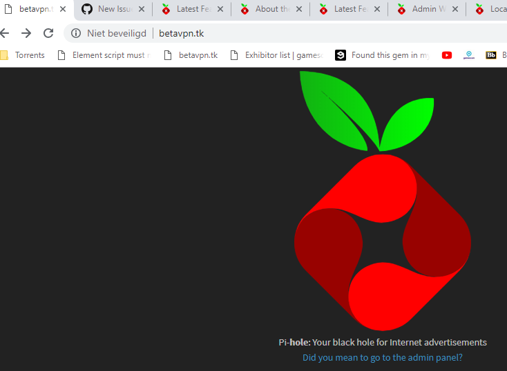

So currently i got PiHole working again on my VPS, even have it working with my custom domain and also made the switch from lighttp to nginx (and therefore got https also working!)
Even the load on the top left suddenly works (always had crazy values like 10) and the only last thing what is left to do is to get the error404 from lighttp setup.
My current configuration with NGINX:
I hope someone is able to tell me how i can set the Pihole error back.
unrelated question: is there also a darkmode for the dashboard? Would i need to change anything else if i would make a subdomain like pihole.betavpn.tk?
Are you referring to the blocking page that shows that a domain is blocked and has the option of whitelisting that page?

Are you trying to get NGINX to serve a specific page, when encountering a 404 situation?
If so, that is more of an NGINX configuration issue rather than Pi-hole specific. But this should help you out:
https://www.cyberciti.biz/faq/howto-nginx-customizing-404-403-error-page/

Would it be sufficient to copy the code from the Pi-hole one to the NGINX one? Its a pretty straight forward HTML/CSS page that Pi-hole serves by default. So that should probably do the trick? Or am I missing something?
lighttpd from Pi-hole has got these directives if might help:
pi@noads:~ $ cat /etc/lighttpd/lighttpd.conf
server.error-handler-404    = "pihole/index.php"
So full path to the 404 handler with a default install is:
/var/www/html/pihole/index.php
index.php and blockingpage.css can be found on git:

Visiting a bare root URL like your link will automatically redirect to /admin/. You will not see the block page for htttps as that's considered a man in the middle attack, unless your clients have your Certificate Authority installed in their browsers.
https://pihole.deltabot.me/ already redirects to https://pihole.deltabot.me/admin/
If you want it to do / show something else then you will need to modify the webserver to do as such.
