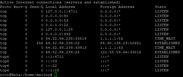

Use below one to check listeners/daemons:
sudo netstat -nltup
And decide which ones should be opened up in the firewall and to whom.

Close 4711, you're allowing the pihole-FTL API to expose your entire setup. https://docs.pi-hole.net/ftldns/telnet-api/
Yep, now you just have to secure the open SMTP server and you are mostly configured.
