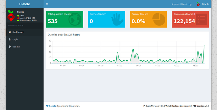

run a pihole -r and repair.
See if you can access the interface after that.
Looks like it worked! Thanks
