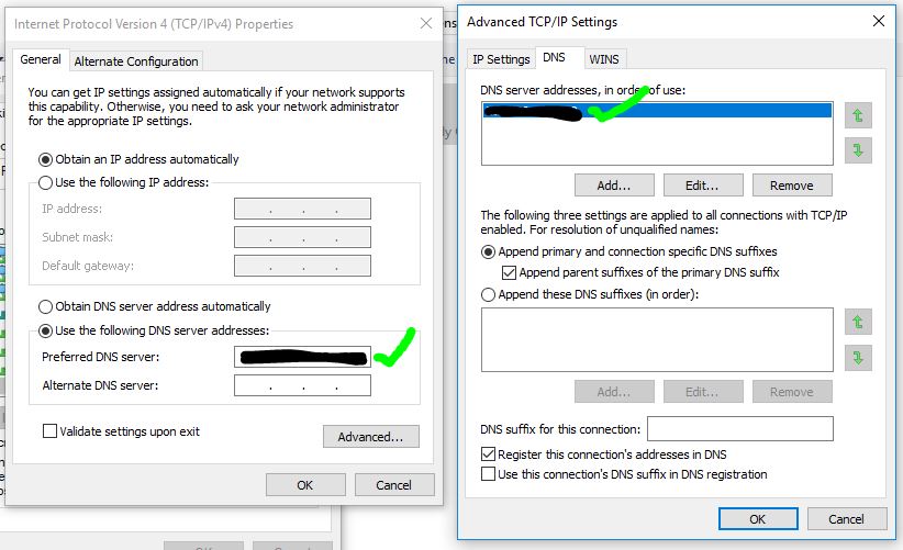

I have it set up by device. There is currently only one device connected to Pi-hole (the pc I am using to type this). I see some queries in the web dashboard. Those are connections from programs running on my computer (dropbox, google, origin, etc). It's the browser that doesn't seem to want to cooperate (Google Chrome if that matters).
