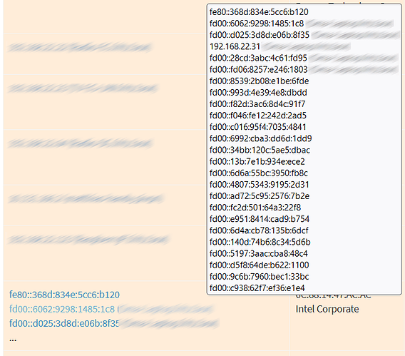

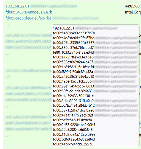

Here a screenshot from the network table.
This device show up as I like it. First entry is the IPv4 and second to n are all the other IPv6.
On this device it start with some IPv6 and the single IPv4 is only in the list. On the normal page it is not visible at all, because it is not in the entry 1-3. It is only visible in the tool tip.
My suggestions would be to show the IPv4 always as the first. And second to n used for the IPv6. Then the IPv4 is always visible in the normal page on the first position.
I hope it is more clear now.
