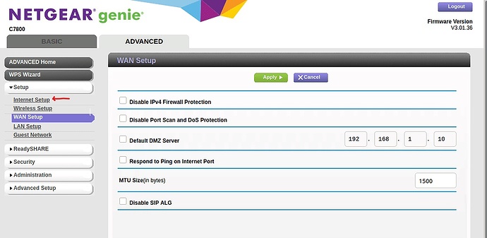

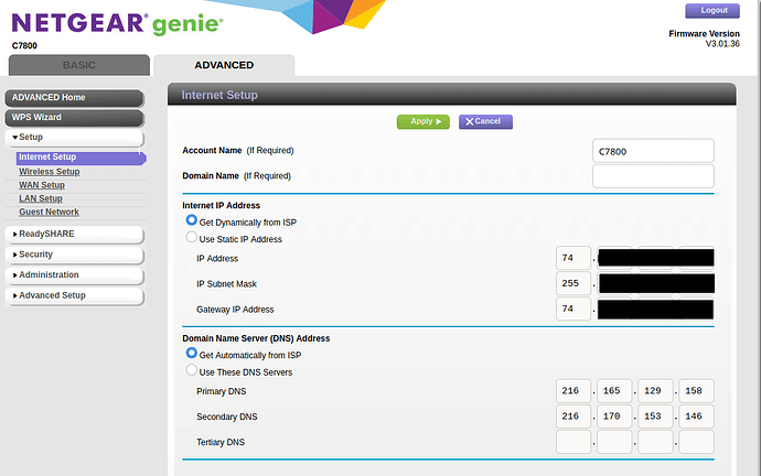

When I make the Pi the only DNS on the router all internet stops working. I have come to the conclusion that this is some type of setting on the router causing this. The Netgear C7800 is a router/modem combo, which lacks settings and customization. I believe one suggestion to remedy this problem is to turn off DNS rebinding. There is no such option, and I have looked thoroughly. I will not be buying a combo again. I have given up on this option and moved on to DHCP only.
DHCP
What is working: All connected LAN devices. (Linux, Samsung TV, Windows)
What's not working: All devices connected via Wifi. (Macbook, Linux laptop, Android)
What I've tried: Resetting the router and changing the router IP (gateway) and disabling DHCP on the router before any devices were connected besides the RPi with a fresh install of Raspbian and Pihole.

Can you configure Pi-hole as your router's upstream DNS server (likely a WAN/Internet setting), local DNS server (likely a DHCP setting) or both?
Setting Pi-hole as local DNS server would be the preferred way.

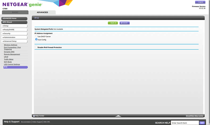

To confirm this, try disabling IPv6 on your router.
You are correct the UI allows the user to change the DNS, but the router refuses to connect to the internet after doing so. Unfortunately, because the router is a modem combo the firmware is pushed out by the ISP. As far as I know, there is no way for me to alter the firmware. However, I could be wrong. Nothing I have done allows the Pi to be the DNS directly on the router.
IPv6 is disabled on my router, so I do not believe this to be the case.
EDIT:
After doubling checking IPv6, I am now unsure if it is disabled. The router setting is in a screenshot below. None of the buttons are clickable or options changeable.
This router is a joke. I will be sticking to routers with more accessible firmware in the future.
EDIT2: I went to Pihole DHCP settings and turned on IPv6. Still no luck.

It doesn't seem like you have IPv6 support in your network - I'd assume that your ISP would assign a prefix for you to use, but the only entry hinting at this in your screenshot reads 'Not Available', and it may or may not relate to your ISP's assignment.
Would you be able to confirm through other sources that your ISP provides IPv6 connectivity at all?
