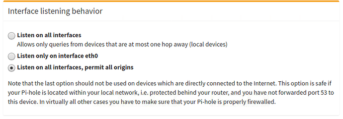

Did you set the Pi-hole to "Permit all origins" ?
It's safe to use it like this in your environment as the router is blocking all requests on port 53 originating from the WAN interface
Yes. I just tried again to make sure. I pointed the router DNS at Pi IP, and I changed the setting to permit all origins. After doing so, my LAN and Wifi devices have no internet connectivity.
