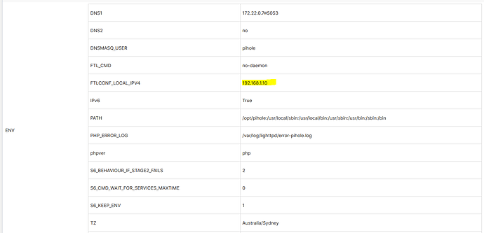

By host you mean the Rasp Pi's IP address? I've done so:
Doesn't seem to have fixed either issue above.
