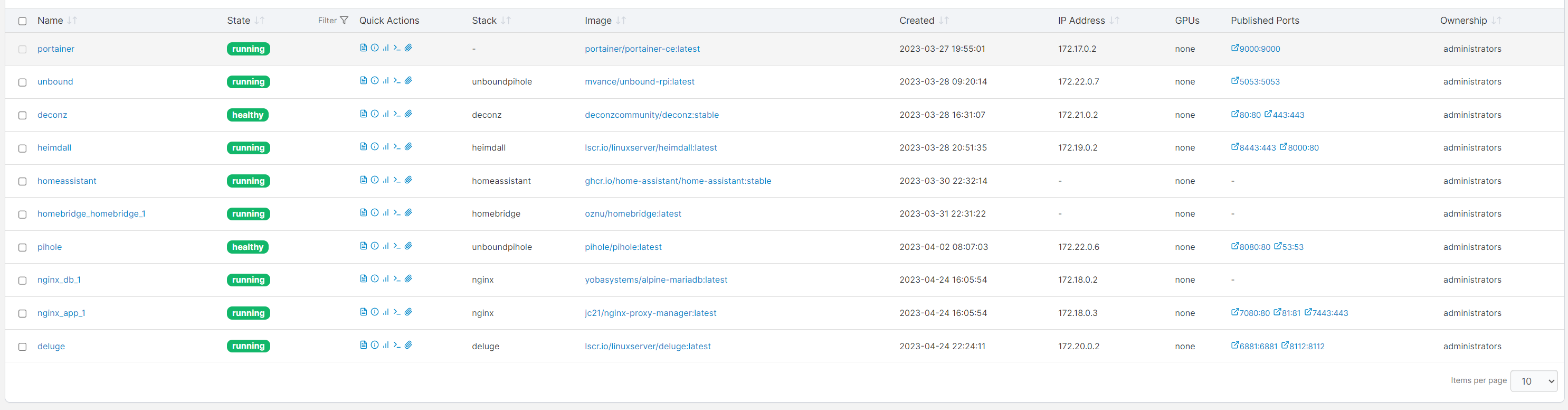

That output suggests that DNS traffic from your network to your Docker host on the defaut port (53) and on port 5053 is correctly routed by Docker to the respective Pi-hole and unbound containers, and that both Pi-hole and unbound are responding as expected.
I am curious about your unbound configuration, though:
Those lines map your host's port 5053 to port 5053 of your unbound container.
But how did you actually configure unbound to bind to port 5053 instead of its port 53 default?
Also, when I asked to verify Pi-hole's required ports, did you change anything on your host OS?
Hmm, I’m not sure how to answer that. As above I’ve followed that guide - maybe the docker-compose is incorrect?
Should it be something like the following?
ports:
    - "5053:53/tcp"
    - "5053:53/udp"
I didn’t change anything on the Raspberry Pi. I’m not sure what you mean by “verify required ports” / did you want me to do something?

It's ok if you didn't change anything - the dig results show that your machine is responding.
I cannot answer that.
Nevertheless, it's what I would expect if you did nothing to configure unbound within its container.
As a DNS resolver, unbound would bind port 53 by default.
But the maintainer of that image may have preconfigured it for a different port within that image.
I'd expect that to be a documented feature if it is - you should probably check that image's documentation.
In the meantime, it wouldn't hurt to give that setting a try to see if it fixes your issue.
It's easy enough to apply and revert those changes. :wink:
