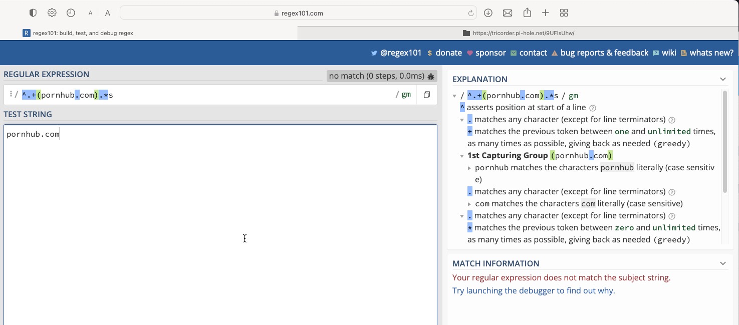

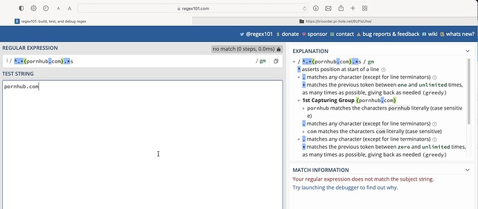

This regex is not doing what you expect it to do:
^.+(pornhub.com).*s
pihole-FTL regex-test pornhub.com ^.+(pornhub.com).*s
[i] Compiling regex filter...
    Compiled regex filter in 0.180 msec
Checking domain...
    NO MATCH!
   Time: 0.129 msec

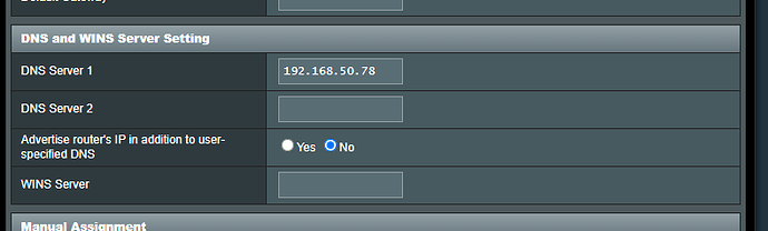

Next, why is my windows client still able to reach pornhub.com? I have ASUS router set up to send to pihole DNS and have turned off "Advertise router's IP in addition to user-specified DNS"
client ipconfig /all only shows my pihole dns
DNS Servers . . . . . . . . . . . : 192.168.50.78

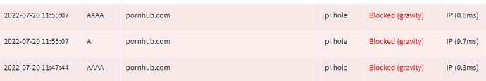

From the Pi terminal, what is the output of the following:
sudo grep pornhub /var/log/pihole/pihole.log | tail -n25
$ sudo grep pornhub /var/log/pihole/pihole.log | tail -n25
Jul 20 08:04:02 dnsmasq[3285]: query[A] www.pornhub.com from 127.0.0.1
Jul 20 08:04:02 dnsmasq[3285]: gravity blocked www.pornhub.com is 0.0.0.0
Jul 20 08:04:02 dnsmasq[3285]: query[AAAA] www.pornhub.com from 127.0.0.1
Jul 20 08:04:02 dnsmasq[3285]: gravity blocked www.pornhub.com is ::
Jul 20 11:41:20 dnsmasq[575]: query[A] pornhub.com from 192.168.50.78
Jul 20 11:41:20 dnsmasq[575]: gravity blocked pornhub.com is 0.0.0.0
Jul 20 11:41:20 dnsmasq[575]: query[AAAA] pornhub.com from 192.168.50.78
Jul 20 11:41:20 dnsmasq[575]: gravity blocked pornhub.com is ::
Jul 20 11:47:00 dnsmasq[575]: query[A] pornhub.com from 192.168.50.78
Jul 20 11:47:00 dnsmasq[575]: gravity blocked pornhub.com is 0.0.0.0
Jul 20 11:47:00 dnsmasq[575]: query[AAAA] pornhub.com from 192.168.50.78
Jul 20 11:47:00 dnsmasq[575]: gravity blocked pornhub.com is ::
Jul 20 11:47:44 dnsmasq[575]: query[A] pornhub.com from 192.168.50.78
Jul 20 11:47:44 dnsmasq[575]: gravity blocked pornhub.com is 0.0.0.0
Jul 20 11:47:44 dnsmasq[575]: query[AAAA] pornhub.com from 192.168.50.78
Jul 20 11:47:44 dnsmasq[575]: gravity blocked pornhub.com is ::
Jul 20 11:55:07 dnsmasq[575]: query[A] pornhub.com from 192.168.50.78
Jul 20 11:55:07 dnsmasq[575]: gravity blocked pornhub.com is 0.0.0.0
Jul 20 11:55:07 dnsmasq[575]: query[AAAA] pornhub.com from 192.168.50.78
Jul 20 11:55:07 dnsmasq[575]: gravity blocked pornhub.com is ::
Jul 20 12:56:11 dnsmasq[575]: query[A] pornhub.com from 192.168.50.78
Jul 20 12:56:11 dnsmasq[575]: gravity blocked pornhub.com is 0.0.0.0
Jul 20 12:56:11 dnsmasq[575]: query[AAAA] pornhub.com from 192.168.50.78
Jul 20 12:56:11 dnsmasq[575]: gravity blocked pornhub.com is ::
