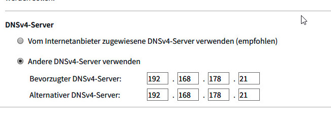

My Pihole can't resolv anymore and blocking is offline
My debug token is: fma0uao57d
In the past I updated my Pihole. Then after that Pihole resolv nothing, webpage blocking and block ads won't work.
dnscrypt-proxy, unbound+dnsmasq works great but only pihole is working anymore.
pihole -g is working to resolv names and download block-lists but:
[✗] Failed to resolve enayahstore.com;1 via Pi-hole (192.168.178.21)
Also won't work:
http://pi.hole/admin = This site can’t be reached
pi.hole’s server IP address could not be found.
PLEASE HELP me! Many thanks!

Fritz.Box Router DNS:
192.168.178.21??? [PIHOLE_ip local] static
Set the static IP address of your PiHole as the DNS server on your router. Then all DNS traffic routes through the PiHole.
You currently don't have a DNS server assigned in your PiHole. Set the DNS on the PiHole to the server of your choice. For troubleshooting, you can use Google at 8.8.8.8.
Is that set correctly? (my Router)

It looks like the router settings are correct for DNS.
I'll defer to others with more expertise on dnscryp-proxy for the settings. I don't use that and don't want to steer you wrong.
