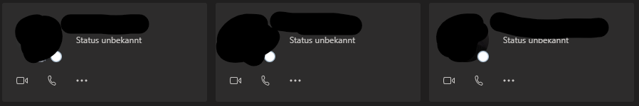

MS Teams gets no presence status for contacts
MS Teams and Outlook should show presence status of contacts. presence.teams.microsoft.com should get an IP from Pihole

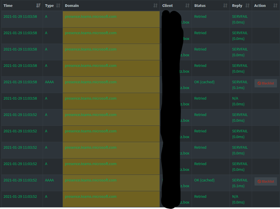

presence.teams.microsoft gets a SERVFAIL

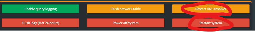

I just used the buttons in the webinterface. Not sure if this might have caused it:

It means that one server on the path to the final answer (Pi-hole -> router -> Cloudflare -> possibly more) refused to reply. Does it happen more often or did it only happen once?
If it happened only once, I would assume a missconfiguration on Microsoft's or Cloudflare's end of things. Which they fixed meanwhile.
If it will happen again, I suggest skipping the Pi-hole and ask the upstreams directly to see who is causing the SERVFAIL. Do something like
dig presense.teams.microsoft.com @fritz.box
to check the fritzbox and similarly to check other upstream servers.
