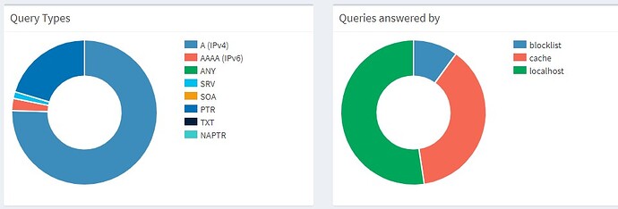

I believe I before under 'Queries answered by' I saw the individual devices, but now I see most of the queries answered by the router (IP address) and next by the localhost and the rest by the cache.
Question is the correct/expected behavior?

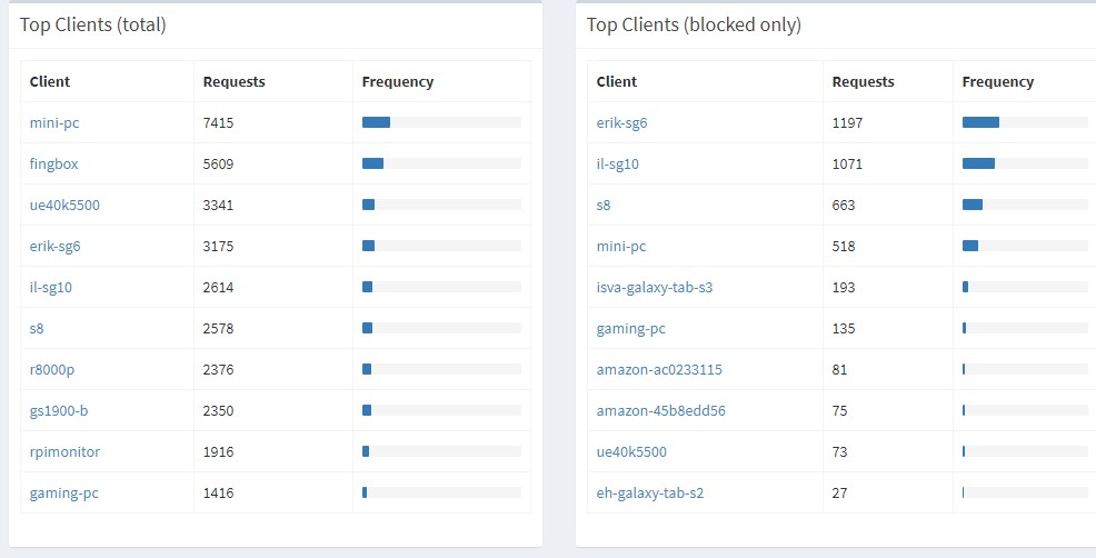

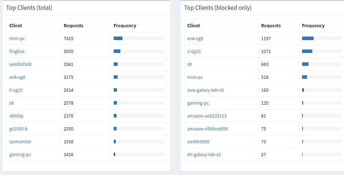

Hi Bucking_Horn,
I am back...
Can I presume photo 1 shows the expected result?
And photo 2 looks right too?
Steen
Those screenshots look inconspicious to me:
All queries are forwarded to your localhost unbound now, if not blocked or answered by cache - no more router showing up unexpectedly.
