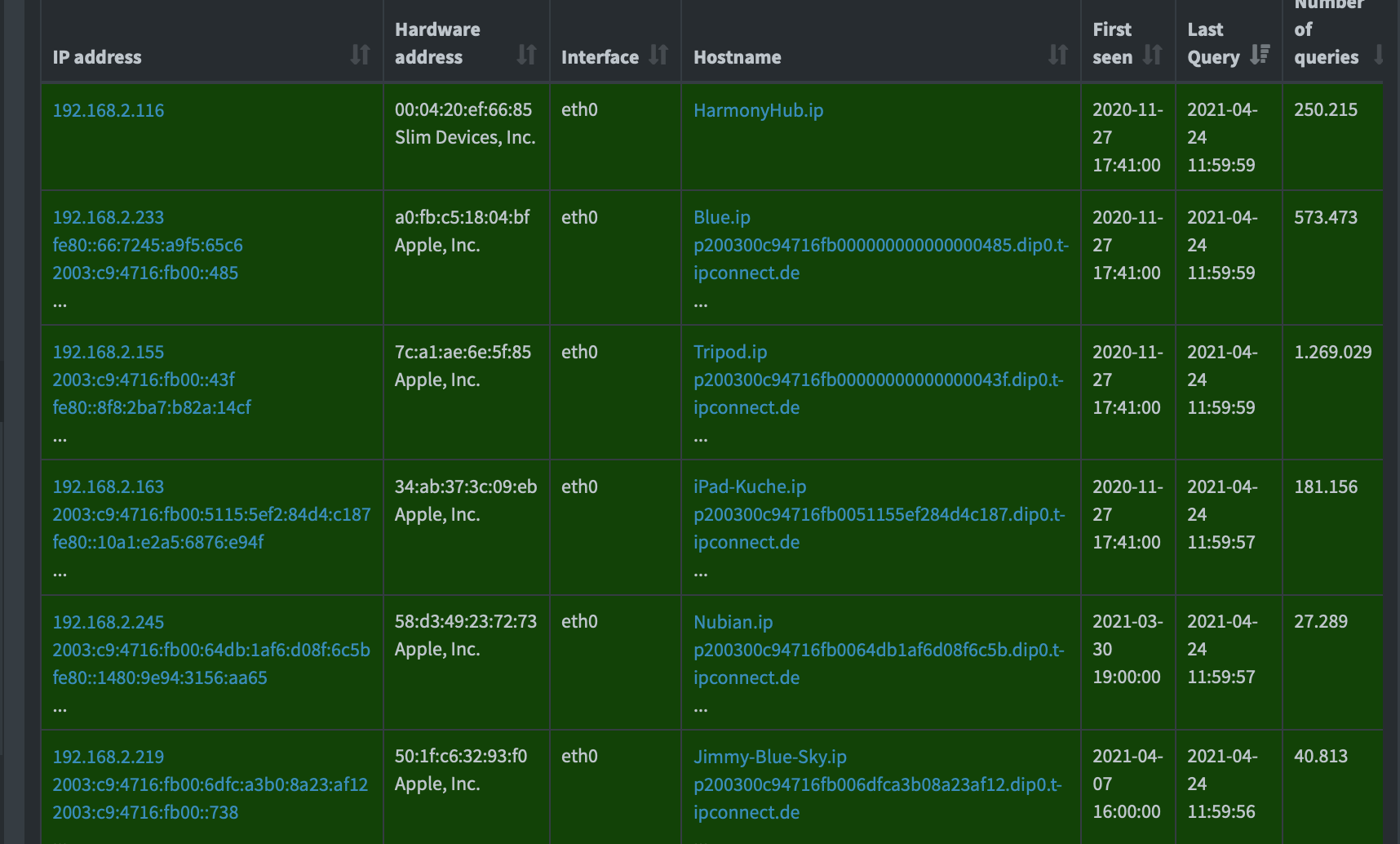

I have enabled IPv6 in my network (DHCPv6 is done by Unifi UDM) and it seems that all clients are not just using their original hostname but also a IPv6 name.
e.g. "blue.ip" and "p2000....t-ipconnect.de"
This makes it impossible to see which client is doing what as the logs are always referring to the long IPv6 name.
Looking in the network section I can see that both names are recognised by pihole.
The manually assigned Hostname shall be used and logged
The additional IPv6 hostname is used and logged

You are observing the expected behaviour for reverse-resolution of a public client IPv6 address.
Your ISP owns the IPv6 address space it has assigned to you and is thus handling DNS for it as well.
As it is a client's decision how to pick the IP address it uses to issue DNS requests to Pi-hole, there is nothing you can configure on Pi-hole's side (at least as long as IPv6 Privacy Extensions are used by your clients).
Instead, you'd have to configure each of your clients and/or your router to change that (see e.g. Using pihole as DHCP server but ipv6 address showing in logs - #6 by Bucking_Horn for a non-comprehensive choice of options).
There is no possibility to set a "leading" hostname if one device (as defined by MAC) does have multiple hostnames. However, Pi-hole has the ability to define "alias-clients" which combine multiple IP-clients.
