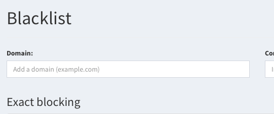

the new blacklist contains some entries from the former whitelist.

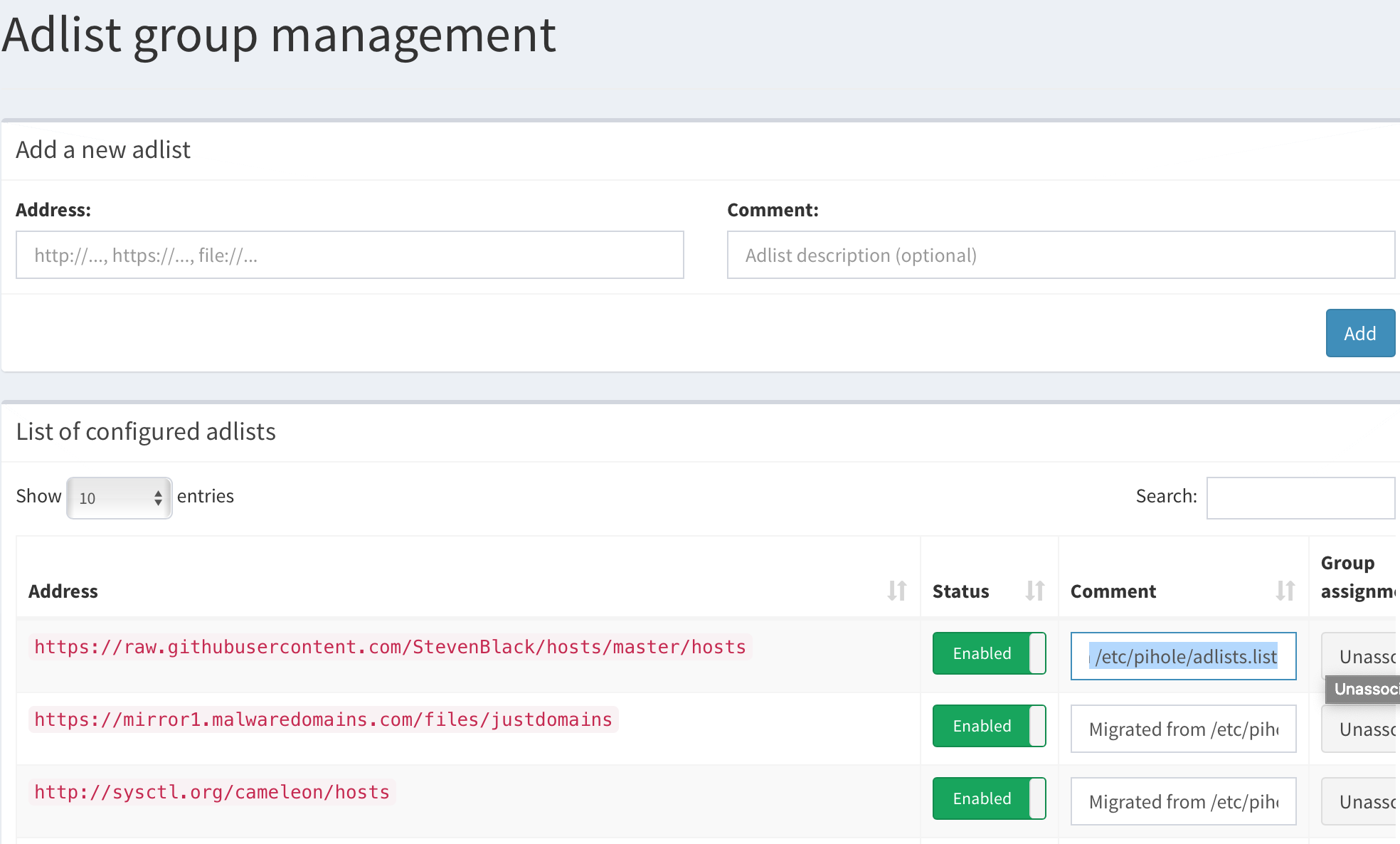

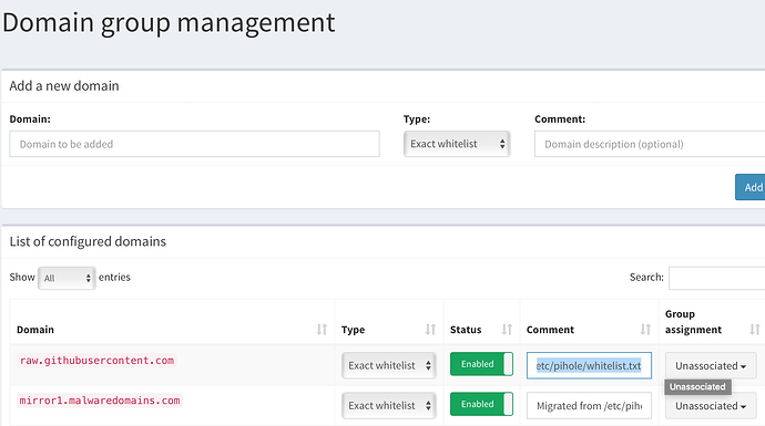

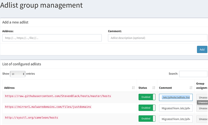

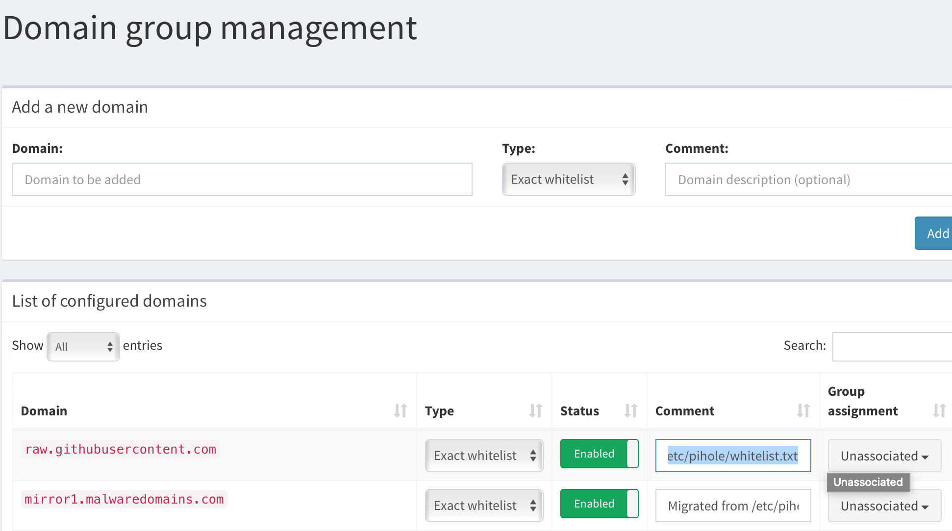

This issue is that (a) noone else reported this (okay, you may just be the first one, so that's not ruling it out) but (b) that I closely followed the code now and don't see how they can land in the wrong table. Maybe it is just a displaying issue, can you check on the new "Group Management -> Domains" page if they are off there as well?
there only such like Migrated from /etc/pihole/adlists.list
But remember please, I deleted the wrong imported entries manualy.
And this is on the Domains page? Not the Adlists one?...
I misunderstood the question
