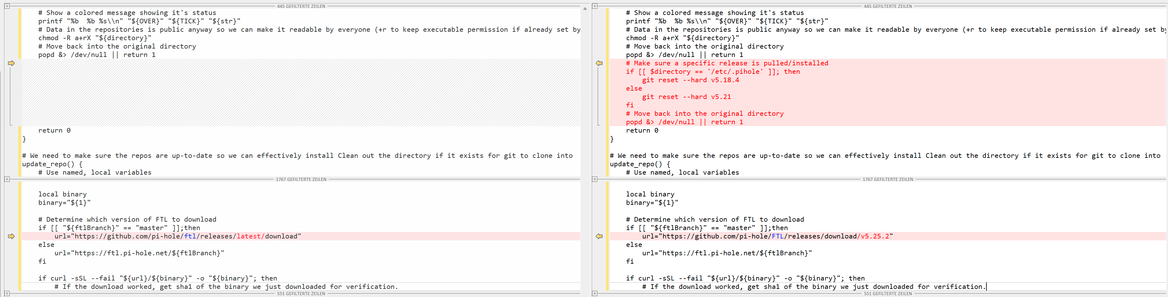

  1. modifications to basic-install.sh:
(overview:)
2.a) Add this at the end of the make_repo function (replace the existing last 3 lines):
    # Make sure a specific release is pulled/installed
    if [[ $directory == '/etc/.pihole' ]]; then
        git reset --hard v5.18.4
    else
        git reset --hard v5.21
    fi
    # Move back into the original directory
    popd &> /dev/null || return 1
    return 0
2.b) Search for url="https://github.com/pi-hole/ftl/releases/latest/download" and replace it with url="https://github.com/pi-hole/ftl/releases/download/v5.25.2".
  1. Then run the installation with sudo ./basic-install.sh
