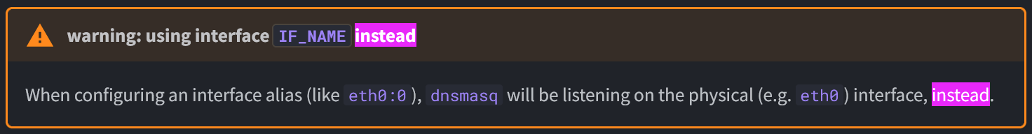

c)
http://192.168.0.55/admin/messages.php
shows
which according to dnsmasq warnings - Pi-hole documentation translates as
and I'm not sure I ever saw this on the old host with the other method of setting up the virtual eth0:0 interface (not sure if related)
--> fixed (not shown anymore) after changingDNSMASQ_LISTENING

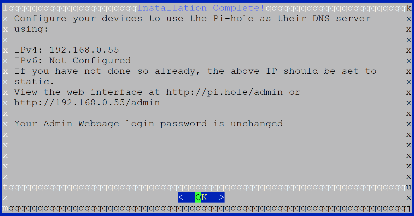

I meanwhile also already ran pihole -r
(with custom changes to remain at the latest v5 release), unfortunately both by choosing the "repair" as well as the "reconfigure" path, it (still) defaults to the physical eth0 interface IP address:
I ran completely out of ideas for what reason and on how to convince Pi-Hole to not use the primary/physical eth0 IP (192.168.0.55) but only the virtual eth0:0 IP (192.168.0.99).
