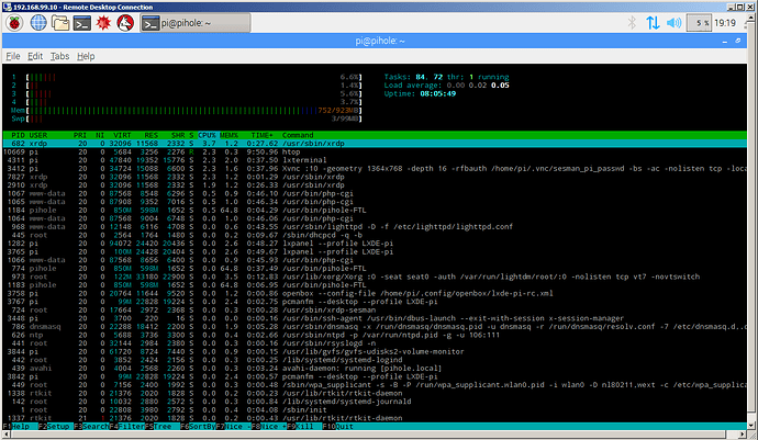

Can you post a screenshot of a terminal (possibly maximized) showing htop? If it comes from FTL we should investigate what is happening.
How many queries do you have in memory and how large is your memory (which device?).
Hi. TU. I'll work on the screenshot. Meanwhile I will need some help here ... "htop?" Kindly define that for me?

More on htop can be found here: htop - an interactive process viewer
It is a resource visualizer for both memory and CPU and will list detailed which process consumes how much of each.
In case it cannot be found, you'll have to install it using
sudo apt install htop

Hi. Here's a screenshot of htop in operation:
The Pi 3 is using a 32GB micro SD card. Presently I have a log file of 827.88kB (no idea what it was before brute-force reboot). Memory usage is running between about 16.3 and 17.9%. It's working fine -- for now. (This pi's sole mission is to run PiHole.)
Thanks for the tip on htop!
Rick
Thanks! Everything looks perfectly fine.
Maybe your issue was one of those that magically fixed itself unexpectedly. Nevertheless, we are of course here to help/discuss further in case you encounter any further issues with Pi-hole.

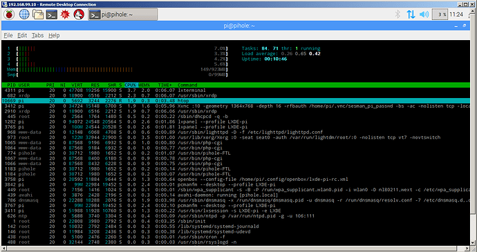

Hi. More info. I returned to the office this evening and I see that memory usage is now 82.0% and climbing slowly. The "memory usage" icon is red. If I am reading this correctly, PiHole was using .2% of memory this morning vs 64.8% now. (The screen shot I sent you earlier today was made shortly after rebooting after I lost access to the pi via RDT and it "Lost Connection to API."

Interesting. The memory usage is climbing fairly rapidly. About 11% when it was booted, now 28%. (log file = 697.73kB.)
On the settings page, PiHole FTL indicates Memory utilization is 16.0% but used memory is 145.14MB.
The card is a 32GB card.
Does that seem right?
How does free look?
Mem: Total 945520 Used 494808 Free 450712 Shared 13004 Buffers 43388
That doesn't look too off the mark for now. If you could keep an eye on it and see how it behaves as time goes on though.
