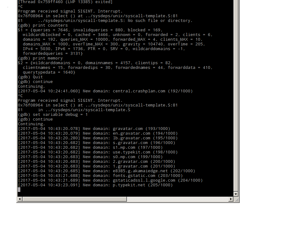

You could go to the window now that has pihole-FTL open in the debugger and do a [Ctrl] + [C] to interrupt FTL. The debugger will it keep running, but paused. You will reach the debuggers interpreter line (gdb)
Please do
print counters
print memory
and post the results (or show screenshots, or whatever is most convenitent for you).
You can then let FTL continue where you interrupted it with
continue
OK. Just I have the results -- trying to figure out how to copy/paste between RDT and anytjhihng else. ;<)
OK, I'll do this manually ...
print counters
$1 = {queries = 7646. invalid queries = 880. blocked = 169.
wildcardblocked = 0. cached 3466. unknown = 0. forwarded = 2. clients = 6
domains = 192. Queries_MAX = 10000. forwarded+MAX = 4. clients_MAX = 10.
domains_MAX = 1000. overtime_MAX = 300. gravity = 104740. overTime = 205.
IPv4 = 5030. IPv6 = 1736. PTR = 0. SRV = 0. windcarddomains = -1.
forwarded queries = 3131}
print memory
$2 [wildcarddomains = 0. domainnames = 4157. clientips = 82.
clientnames = 15. forwardedips = 30. forwardednames = 44. forwarddata = 410.
quit
Note: "Memory usage" in PiHole "status" in web UI is 29.0% and climbing slowly from about 11% after this morning's reboot.
That all looks fine. Please try to switch to debug mode so that FTL becomes a bit more verbose. I never tried to do this online, but you may be able to achieve it using
set variable debug = 1
continue
once you interrupted FTL.
Browse to some site you have not have opened before and you should see some output like
[2017-05-04 16:26:07.881] New domain: 1.gravatar.com (1454/2000)
Let's see if strange behavior becomes apparent like this.
Thanks!
