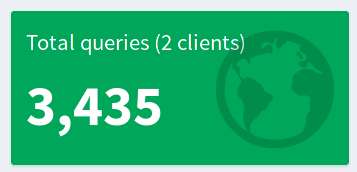

I enabled logging again and memory usage is still increasing permanently.
Please post the output of this command again.
echo ">stats" | nc localhost 4711
