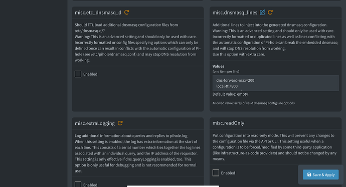

Go to settings and toggle the expert mode on. Then go to all settings, misc settings and look for misc.dnsmasq_lines.
EDIT: Or you can do it via command line.
pihole-FTL --config misc.dnsmasq_lines dns-forward-max=xxxx
Where xxxx is the number you want to use.

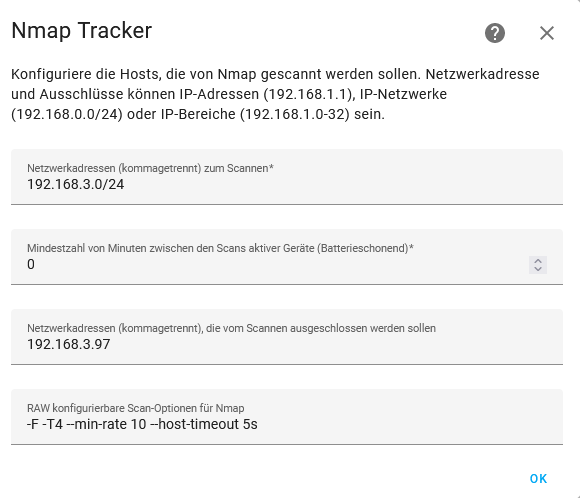

I integrated nmap into HomeAssistant, which regularly scans my private IP ranges to detect new devices. It also performs a DNS lookup.

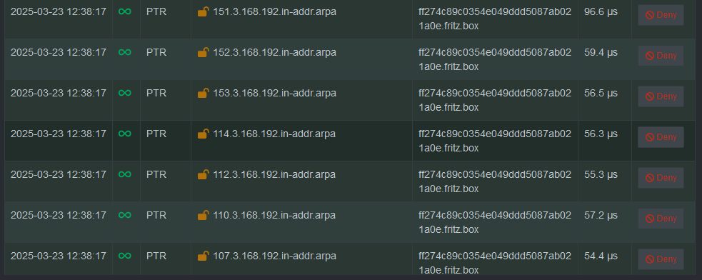

when I have a look in Recent Queries, the nmap-Scanner of HomeAssistant makes a lookup for each IP:
How many of those reverse lookups are sent on each invocation, and how often do those reverse lookups run?
All of those PTR lookups from your screenshot were served by Pi-hole's cache optimiser, which implies they have been forwarded upstream.

at the moment, the scanner checks 3 private class-c ranges = 3x253 IPs

for all IPs in ranges
= detecting devices in network
