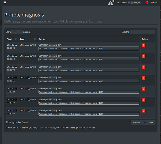

Maximum number of concurrent DNS queries reached
Already found an issue. Three of my piholes are being flooded with maximum concurrent DNS request 150 are being met. Two of the piholes were spammed this 23 -30 times immediately after upgrade.
Is the issue that you are being warned of a limit being reached, where before you weren't? This is a new addition to Pi-hole in this update. The operation of Pi-hole has not changed, but this warning for things happening under the hood was added. This new feature is referenced in the release notes.

yep it is a new warning. Everything seems functional still. I guess i need to raise the size of --dns-forward-max= I think setting it to a adequate value of 1024 should resolve this issue.
The warnings have always been there, somewhat hidden in /var/log/pihole.log, a recent addition just made them more visible by also printing them into /var/log/pihole-FTL.log and showing them on the dashboard:

I don't think rising the limit will help. If an upstream server has issues to respond to queries and there are more than 150 queries awaiting reply from the server, this rather suggests something is wrong with your upstream server.
Please have a look into your /var/log/pihole.log file and look for said
Maximum number of concurrent DNS queries reached (max: 150)
messages.

It appears I have some very Noisy clients on my network causing the problem. Every thing still appears to be fully functional. If it were breaking DNS i would see it as a cause for concern. If the only thing I have to get use to is a bouncing exclamation point on the GUI, then i am fine. If i know of a way to resolve it, I would though.
