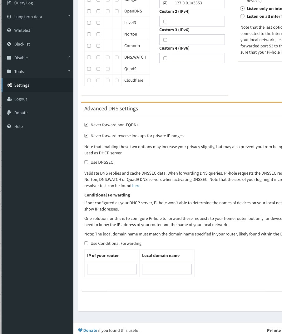

There is a setting on the web admin page (Settings > DNS) for "conditional forwarding". Enabling this allows the router to provide the names of the connected clients. Select this and see if there is improvement.

If conditional forwarding doesn't work, you can use the DHCP server built into Pi-Hole instead of the DHCP server in your router. With this setup, the Pi-Hole gets the client name directly from the clients during the DHCP handshake, and there is no performance difference between DHCP on Pi-Hole and DHCP on your router.

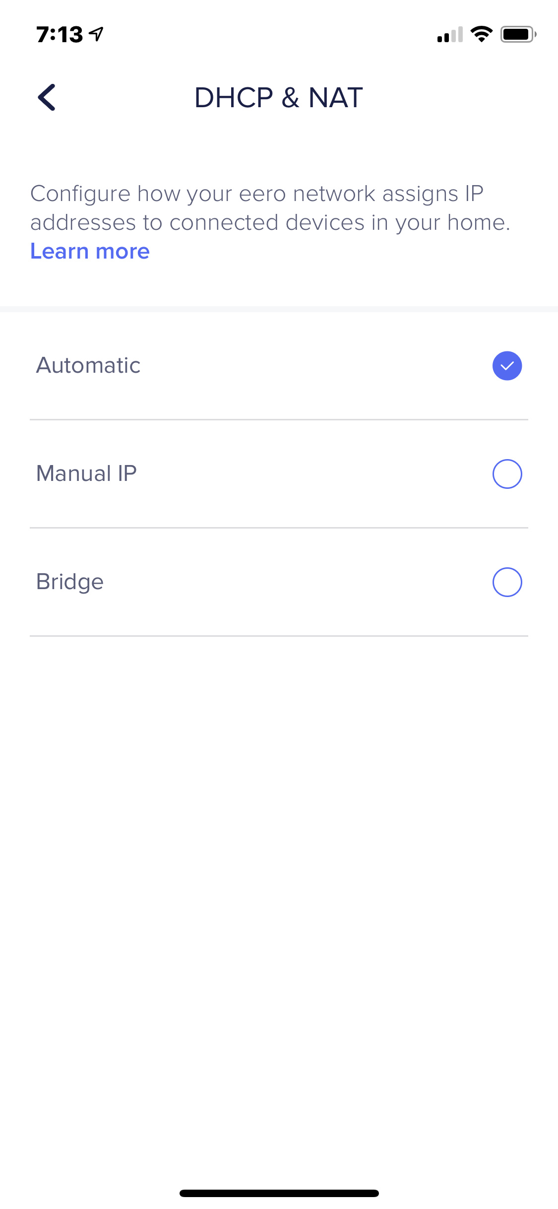

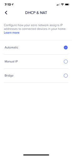

This is all I can do with my Eeros. Below are pics of the three settings I have ( Automatic, manually, or bridge.

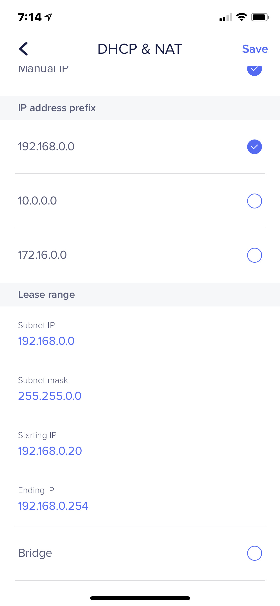

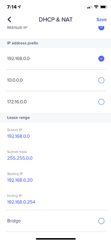

Next picture shows what settings it’s askinf for for manual.
Normally it's not a good plan to have multiple DHCP servers on the LAN, but we can make it work here. We'll set your router as DHCP server for only the IP address of the Pi-Hole, then have the Pi-Hole assign the DHCP to the rest of your network.
