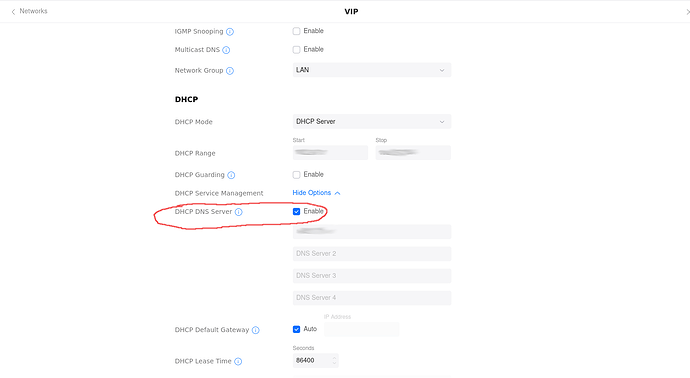

I followed this advice, saying i should change the DHCP Server on my unifi system and point it to my Pi-hole. I did this for all my 3 networks ( Guest, Default & Vip).

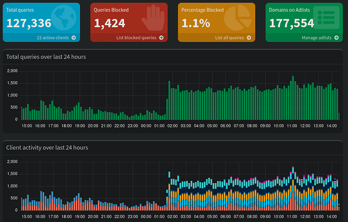

It worked as advertised new clients started showing up on the interface, but now i have several queries per seconds, non-stop...
(I've made this change a little before 02:00 am)
Should i be concerned ? Could my raspberry pi overload ?

You can hover your mouse over the bars in the graph and see which clients are making the requests. You can also click the bars to see a selection of queries from that period. Don't be alarmed – your clients are doing all this DNS chatter on the network all the time, it's just that now for the first time you are able to see it. Your Pi is safe and won't overload, this is all easily handled by your Pi and Pi-hole.

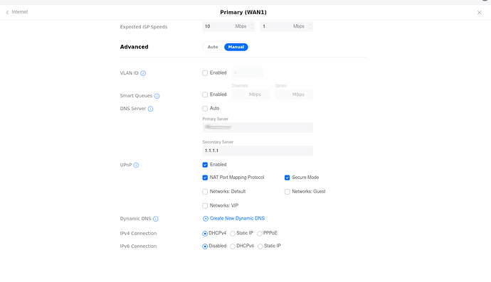

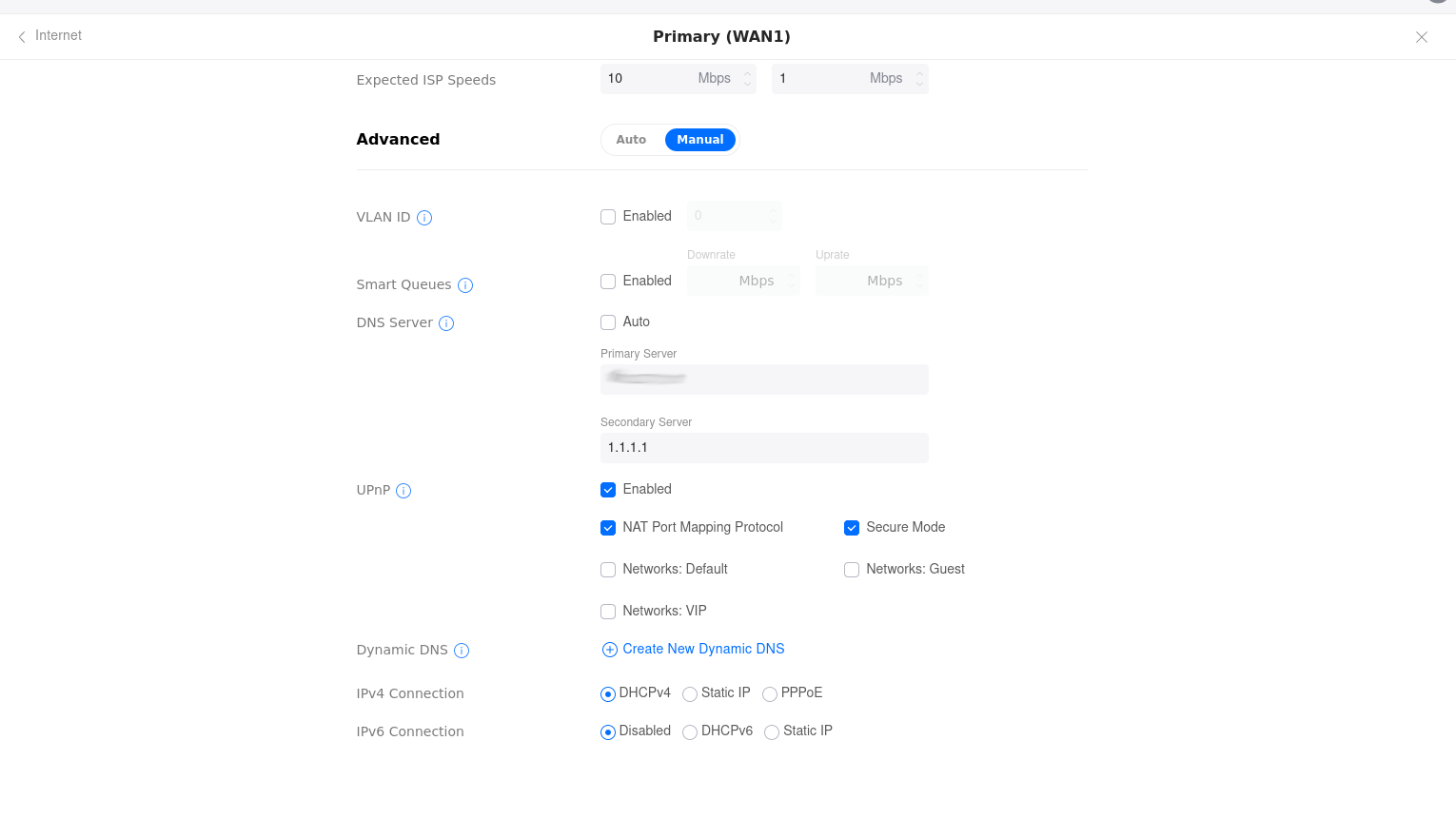

Before I just had my UniFi DNS Server pointed at pi-hole. Like this:

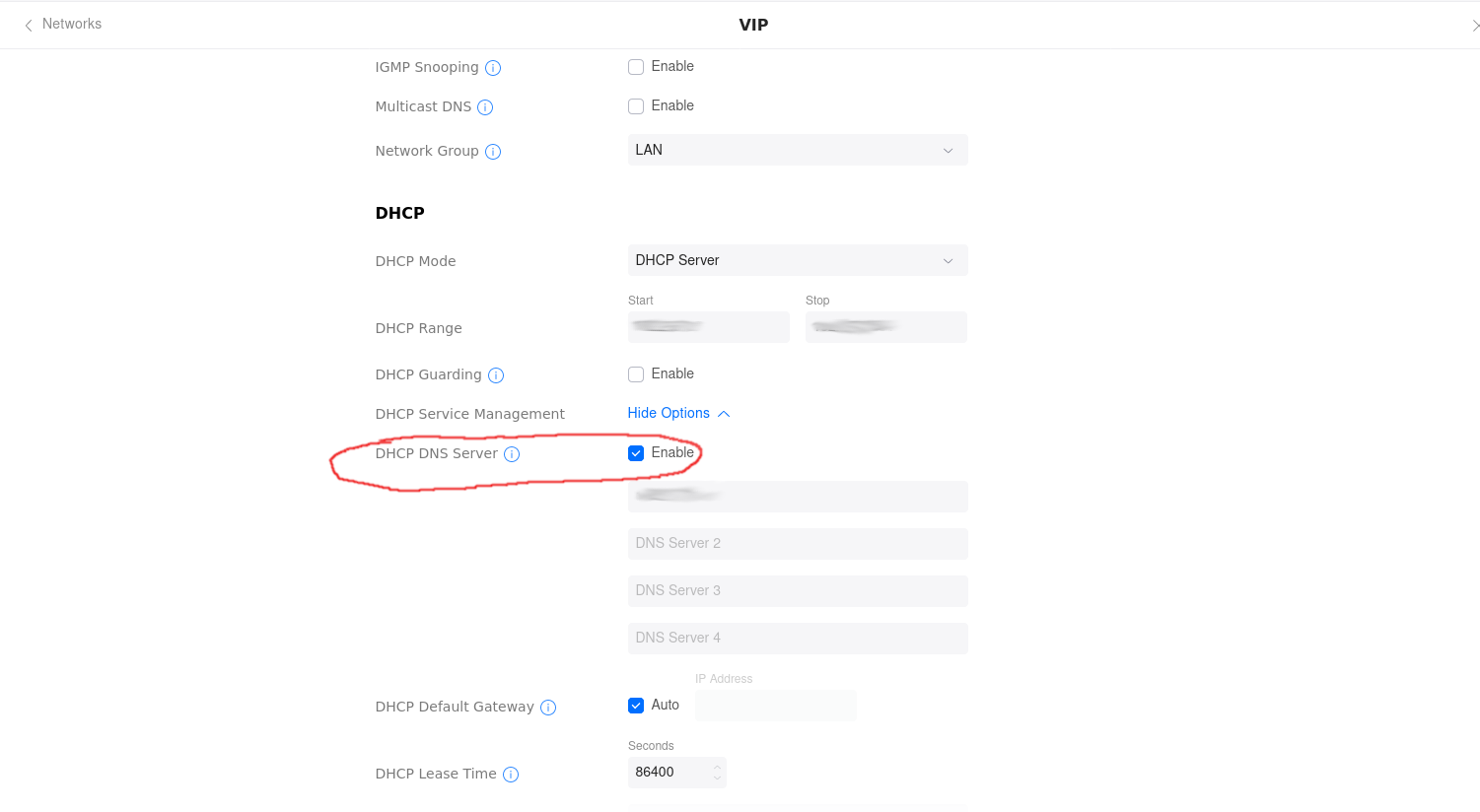

Now, i added the following settings to all 3 networks.
(Activate DHCP DNS Server)
it's turned off, should I turn it on?

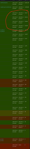

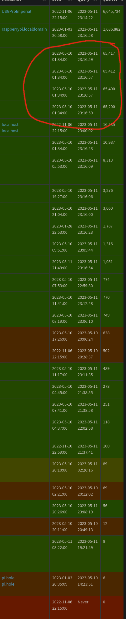

Also after further debugging I believe, i found what seems to be the issue however i don't know to resolve it...
After looking at the queries, I have 4 devices that excessively high queries and all within the same range. Between 55,547 and 55,563 queries.

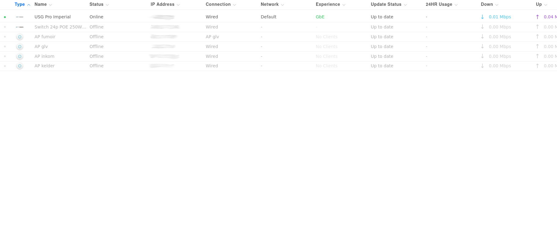

When i went to look at the IP addresses they correspond to my 4 Unifi access points, which on my unifi Web UI appear offline, even though everything is working fine and i have WiFi in all areas

You had Pi-hole as primary and 1.1.1.1 as secondary.
This probably caused Pi-hole to be bypassed.
In most systems primary and secondary are used at the same time.
Now you set only one DNS server and the DHCP server is advertising only Pi-hole's IP. All device are using Pi-hole.
This is probably one of the reasons for the increased number of queries observed here.

Before I had my UniFi system set to use Pi-hole as a DNS server, now I've kept that setting and also added Pi-hole as the DHCP DNS Server as shown in the screenshots above.

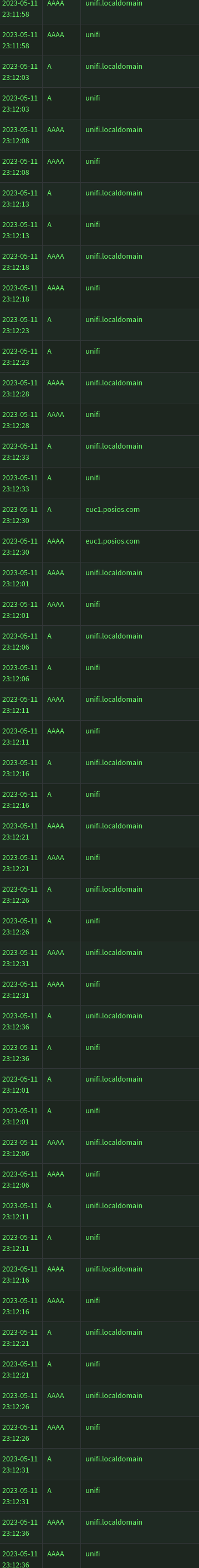

Yes, you seem to be correct as all the new queries come from the 4 access points that currently appear offline (even though, they are working normally), and they are all pinging Unifi and unifi.localdomain.
Looking at the query log I don't think net data is the issue

From the info I could gather, it seems my access points, are not able to ping my USG PRO.
Thus why they appear offline and keep querying Unifi non stop ? :thinking:
