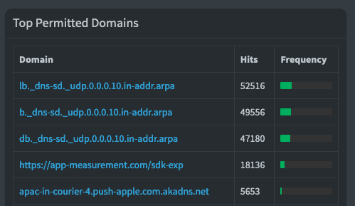

I have my pi hole generating excess queries from *.0.0.0.10.in-addr.arpa , app-measurement.com/sdk-exp. I googled, of course. Disabled DNSSEC, Conditional forwarding, but I still get hit over by rate limited. In a normal enough network, it should never have happened.
Apple devices on network : Macbook, 2 ipads. No printers or other bonjour devices.
-Raspbian 32-bit lite
-unbound, pretty much vanilla config file.
-Raspberry Pi 2 v1.1
As above, those query numbers are in 3-4 days. I get that based on number of devices, either I have to increase rate limit or there is a loop in resolving DNS requests. I followed this post and got to know pi hole is forwarding DNS again to my router, which I assume is forwarding again to pi hole. Known from running this: grep -n "New upstream" /var/log/pihole-FTL.log

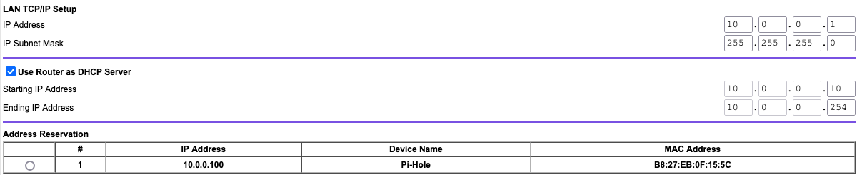

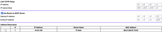

I am sure I set up my router correctly. I even rebooted router and got another debug log, it still shows 10.0.0.1.
I understand router is doing that, but not why. Is this router specific problem? Should I try with another device? The current one is pretty old, Netgear JWNR2010v5.

Asterisk as in wild card, as shown in screenshot. There are multiple domains ending with 0.0.0.10.in-addr.arpa. I put this in because this thread may be helpful for others who have similar problems as mine.

I don't think I can config router to distribute pi-hole's IPv4 via DHCP. Its simply too old and feature lacking.
