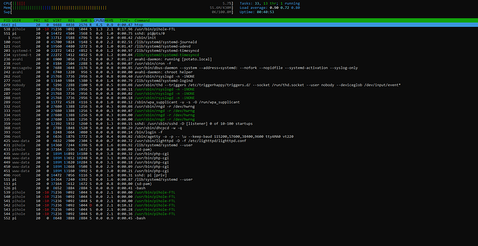

Which hardware is it, and which process causes this high load? Can be monitored e.g. with htop.
Sorry I forgot to mention, it's a pi zero, I have an Ethernet hat on it also. Which column in htop do i need to look for the highest load in?
CPU%, usually the list is sorted by it, so the processes with high CPU usage appear at the top.
Top of the list is pihole /usr/bin/pihole-FTL

Occasional long term load averages greater than one typically will have zero performance impact on your Pi-hole.
There are certain processor-intensive activities that will occasionally stress your CPU Rebuilding gravity (particularly with a large number of adlists), updates and repairs, etc.
With the slight CPU "overload" you are seeing, I would not be concerned.
Here is a good sicussion of Linux loads.
That is a relatively low capability device. It is plenty powerful to run Pi-hole (I have three running), but when you get to processor intensive tasks, the relatively limited CPU becomes a short term bottleneck.
It would help us to see the entire list.
With a low power CPU like the Zero, it is not unusual to get CPU demand spikes. Here are the loads on a Zero W (connected via WiFi) after a few routine system activities. At the start, the Pi was just sitting doing its thing processing DNS queries. As we stress the CPU, you can see the 5 minute and 15 minute load averages increase accordingly:

In your screen shot, Pi-hole is using 1.3% CPU - virtually none. And the load averages were lower than reported by uptime 2 minutes later.
I wouldn't worry about this, assuming your DNS performance is good.
