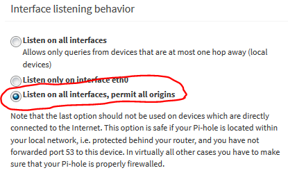

Check if interface configured for Pi-hole is the same as the one holding IP 192.168.0.170:
grep PIHOLE_INTERFACE /etc/pihole/setupVars.conf
ip a
Could be rebind protection:
If suspect rebind protection and cant find any settings related in the router settings, you could connect a PC/laptop configured with static IP directly to the Pi-hole box (no router/switch inbetween) to see if replies to dig/nslook/host etc.
PIHOLE_INTERFACE=tun0
ip a
2: eth0: <BROADCAST,MULTICAST,UP,LOWER_UP> mtu 1500 qdisc fq_codel state UP group default qlen 1000
link/ether b9:23:ec:de:c3:12 brd ff:ff:ff:ff:ff:ff
inet 192.168.0.170/24 brd 192.168.0.255 scope global dynamic eth0
valid_lft 2142sec preferred_lft 2142sec
inet 192.168.0.171/24 brd 192.168.0.255 scope global secondary noprefixroute eth0
3: wlan0: <NO-CARRIER,BROADCAST,MULTICAST,UP> mtu 1500 qdisc fq_codel state DOWN group default qlen 1000
link/ether d2:4e:4f:35:8d:e4 brd ff:ff:ff:ff:ff:ff
4: tun0: <POINTOPOINT,MULTICAST,NOARP,UP,LOWER_UP> mtu 1500 qdisc fq_codel state UNKNOWN group default qlen 100
link/none
inet x.x.x.x/24 brd x.x.x.x scope global noprefixroute tun0
The x.x.x.x is replacing a real ip.
Try change below Pi-hole DNS setting:
Lol, I only have CLI.
Edit: You mean in the pi hole admin settings.
THANKS. IT WORKS. YOU ARE MY HERO!
You can change with cli ... hold on :wink:
