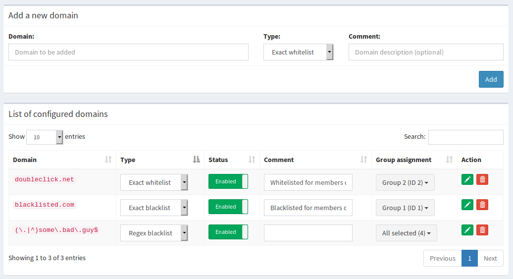

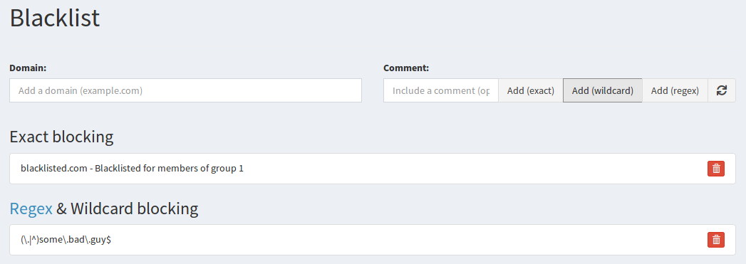

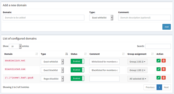

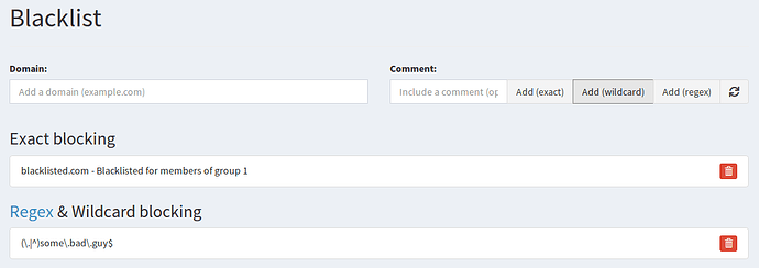

To make things clear to the user, we retitled the three categories
  • blacklist
  • whitelist
  • regexlist
and added a fourth one:
  • exact blacklist
  • regex blacklist
  • exact whitelist
  • regex whitelist
The exact and regex versions of a list are shown together on the same (e.g. blacklist) page:
We're also currently investigating to switch this more traditional displaying to a common page showing all four domain types at once. This would have a number of benefits like allowing us to, e.g., allow user to easily change a white to a black regex or integrate per-client group management, etc. This is currently under review:
