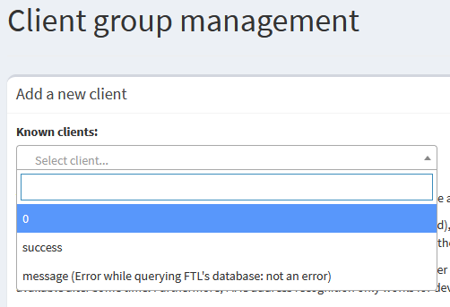

Erm, no, I created the 2nd instance from scratch (again, sic), saw that all tabs were empty (except for the Default group. I entered 192.168.178.1 as client. It did not appear below (despite the green confirmation pop-up), and after a refresh (F5 key), it shows Loading... without any client added. I`m going to upload the debug log...
PS - now the GUI shows this:
I wonder what is going on...
