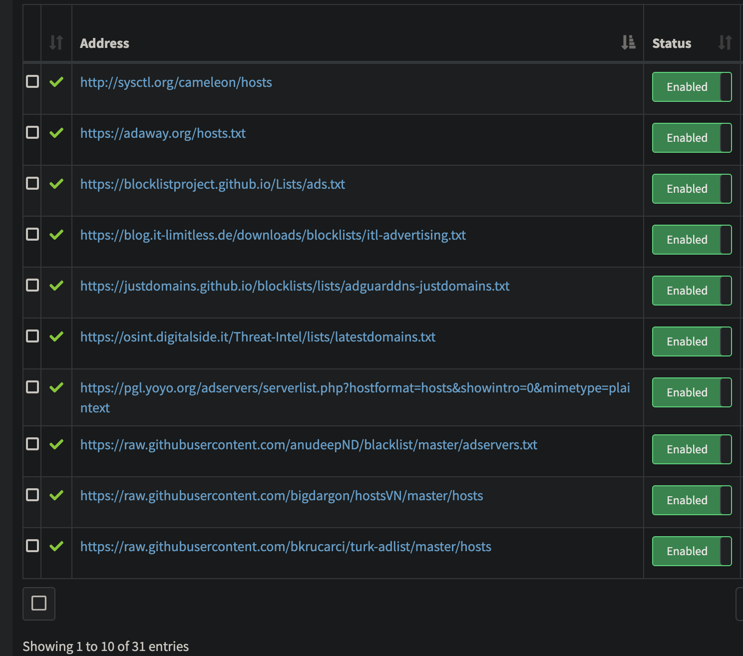

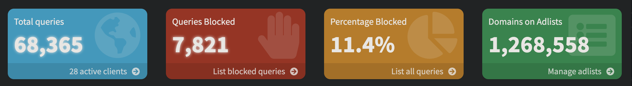

I run pi-hole on a Raspberry Pi 3B+, 1 GB RAM, 1 GB swap file, bare metal no docker, on Raspbian 10 Buster. I have 31 active adlists, almost 1,270,000 domains combined in the DB. All of the lists are
small lists. Either in the latest pihole update, or before, it never took more than a few minutes to compile the database. I did not see anything unusual with this update core 5.16.1, FTL 5.22
