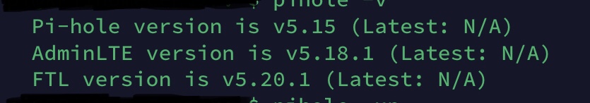

@jfb Immediately after updating Pi-hole to the latest release, I see the same again:
Therefore I removed the „solved“ of this topic.
Please assist. I won’t provide a full debug token - tell me what you need.
Otherwise I‘ll just restartdns or do a repair again - so this will never get solved.

b) „pihole -r“ did NOT fix this this time. Still
Pi-hole version is v5.15 (Latest: N/A)
AdminLTE version is v5.18.1 (Latest: N/A)
FTL version is v5.20.1 (Latest: N/A)
So it looks like the latest version information simply can’t be grabbed from (GitHub?).

Running „pihole updatechecker“ once updated the versions file and fixed this immediately:
Pi-hole version is v5.15 (Latest: v5.15)
AdminLTE version is v5.18.1 (Latest: v5.18.1)
FTL version is v5.20.1 (Latest: v5.20.1)
I bet all this started when you changed the way/interval updatechecker is run. It probably simply has not since the update (been a few hours…), until I ran it manually now. Probably related to
