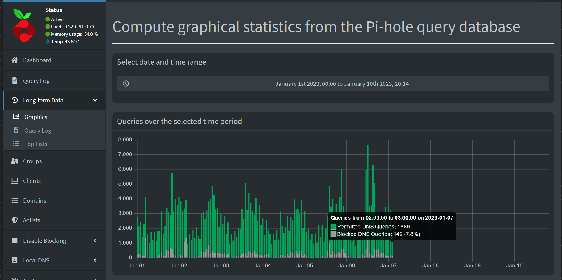

Clearly the database was locked for quite some time. We'll probably never find out why. This is what the dashboards currently look like AFTER running pihole -r:
Seems to stopped working on 2022-01-07 after 02:45 in the morning. I could not find any cron job or something which ran at that time.

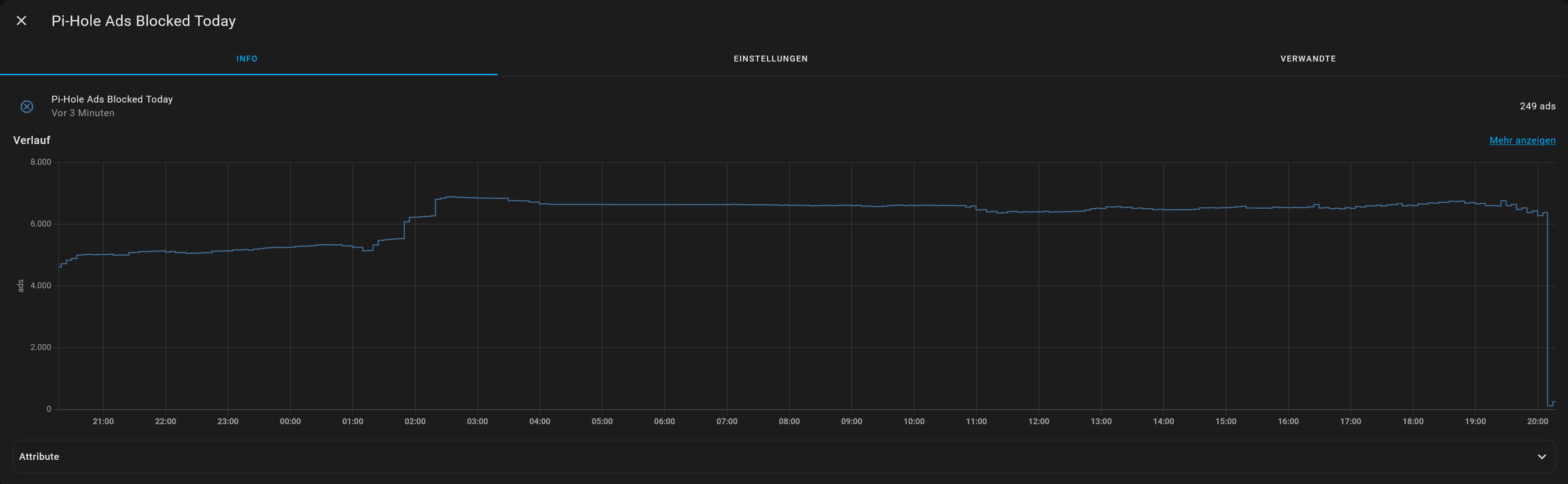

Interestingly the data came out fine (imported in Home Assistant) which is why I did not discover this database issue of Pi-hole earlier - and all data dropped now after running pihole -r:

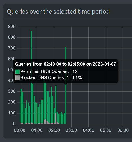

So immediately after
[2023-01-07 02:46:00.000 22031/T22048] WARNING: Long-term load (15min avg) larger than number of processors: 5.2 > 4
the database went into read only / write protection mode. Interesting!
