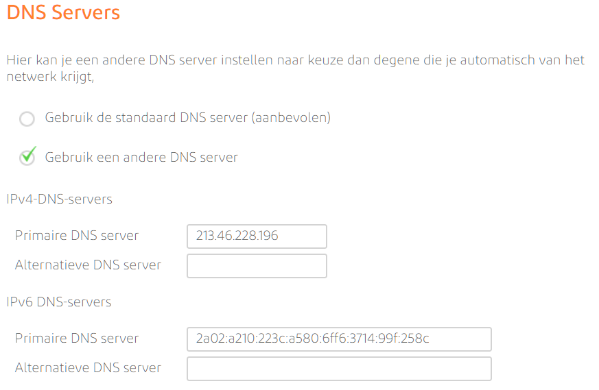

Unfortunately the router doesn't allow fully disabling IPv6. It does allow me to change the DNS servers though. I found the ipv6 by using ip a. I assume that's the one I should be using? The router doesn't allow me to change the ipv4 adress though, it doesn't like local IP's for ipv4 dns for some uknown reason.
For now, it looks like this:

So is it good now?
That looks good for now ...

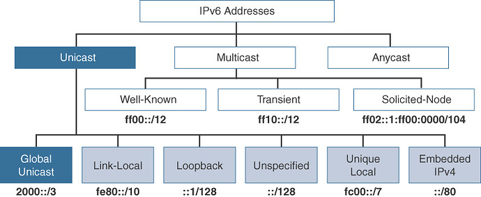

but that 2a02:a210:XXX address is a GUA (Global Unicast) address as can be seen below:
The prefix (being pushed by your ISP) in a GUA address can change periodically.
Meaning the IP can change and most likely will after a while as with many ISP's.
Preferred is to set the ULA (Unique Local) IPv6 address for DNS which doesnt change:
Or if thats not possible, configure the LLA (Link-Local) address of the Pi-hole host.

Above is a LLA from the diagram.
From that client, run the nslookup against this one eg:
nslookup pi.hole fe80::899f:c6be:36ba:3b77
If get reply, configure it instead of the GUA 2a02:a210:XXXX.
