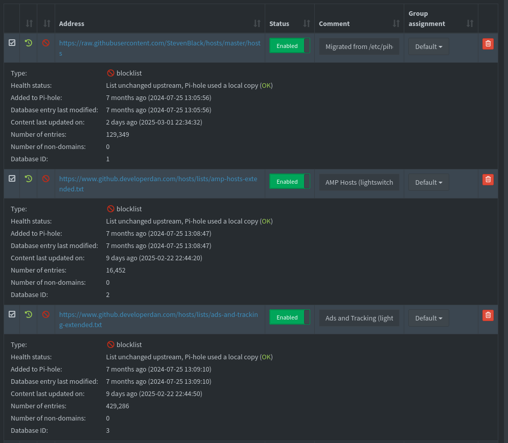

The http vs https move seems to have helped the UI stuff for certain but that was really only half of the story. Having the load average going high while I'm not touching the web UI is still a concern. I am also concerned that gravity isn't updating all of the lists even though it's not giving an error. After running gravity, even if nothing has changed on the upstream lists, it'll always update the "Content last updated on" for each of the lists that I use. Currently only the first list is getting this
The first list being 2 days ago was after the gravity update started running ok but all of the additional lists still show 9 days ago and that time stamp is prior to the v6 update.

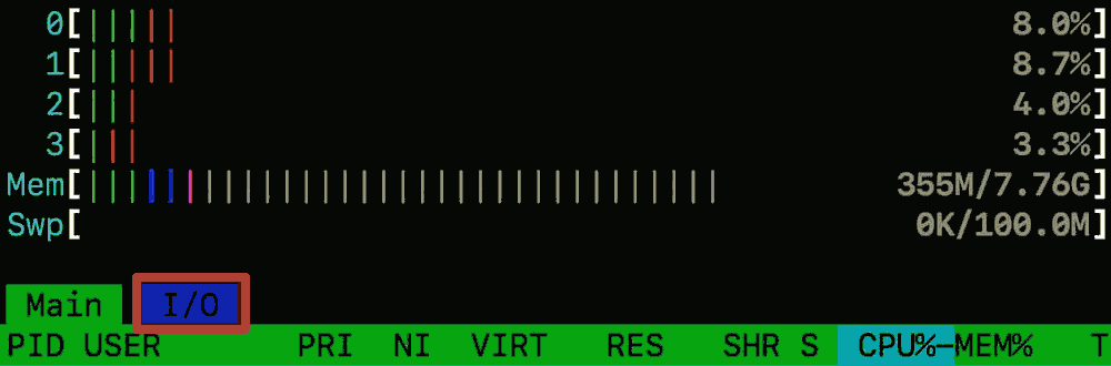

Can you verify that this would be caused by pihole-FTL, e.g. via htop?
If available, don't forget to check htop's I/O tab as well.

I am not well versed with htop so I'm not sure if you are looking for some kind of history feature that it may have but currently there are 2 threads of pihole-FTL that are spiking up to a combined 50% of CPU in frequent bursts. Occasionally I'll see a third pihole-FTL process also spike alongside those but only momentarily. Just to reiterate this is without me even accessing the web interface.
