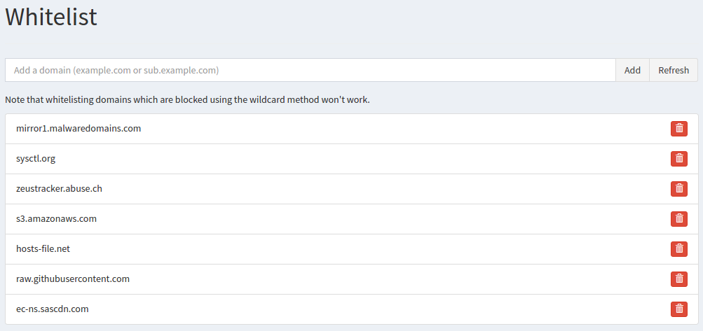

I did the same analysis as you did (looking at the query log and selectively whitelist) and succeeded:
ec-ns.sascdn.com
did the trick for me. If that does not help try two things:
  1. Clear your browser cache (Chrome: chrome://net-internals/#dns)
  2. Tell them (by clicking the two buttons) that you have disabled your Adblocker. It will force the ad-blocker test to be done again.
After some hassle with the cache, I got it up and running. The url you found is the key! Thank you so much for your help, great work!
