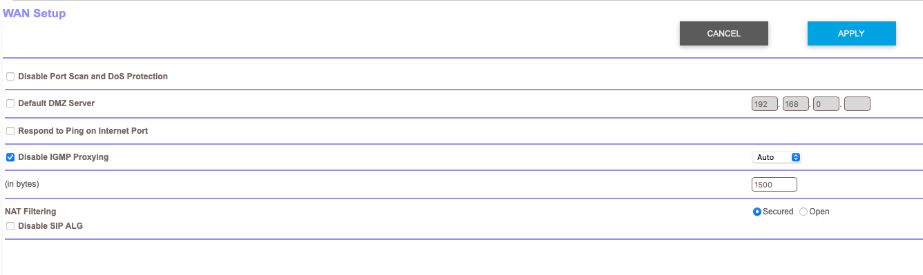

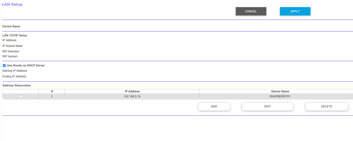

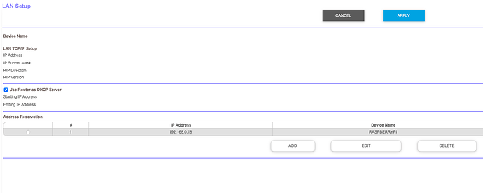

I am struggling with this a lot, PiHole seems to work fine if DHCP is enabled via PiHole. I would prefer to have my router have DHCP active instead for ease of use, performance and in case something goes wrong with my Raspi. I have not been able to find any solution to this so far and was curious if anyone has experience with an Orbi and could help? attached are a couple DHCP options that are available in the menu.
For the network to use Pi-hole while the router configures DHCP, you need to set the Primary DNS setting in Domain Name Sever(DNS) in your Router configuration to the ip address of Pi-hole(it seems to be 192.168.0.18). Be sure to also select “Use these DNS Servers” instead of “Get automatically from ISP”. For secondary and third DNS you either enter Pi-holes ip again or a backup DNS server in case your Pi-hole goes down.
If your router allows the configuration of DNS servers in the DHCP/LAN section, each device IP will show up in Pi-hole.
If your router only allows to config DNS servers in the WAN/Internet section (apparently this is how your router works), then the devices will use the router as DNS server and the router will be the only device using Pi-hole.

This way, your devices will use Pi-hole directly and they will show up in the web interface with their own IPs.
