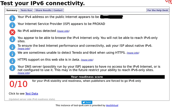

Hey there is results from my W10 PC and from the OrangePi

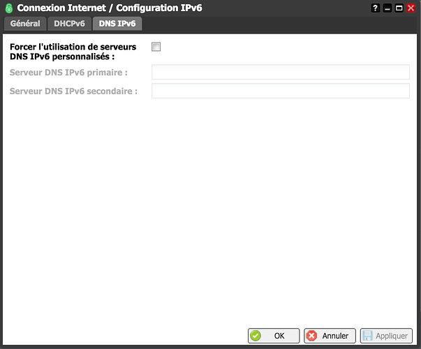

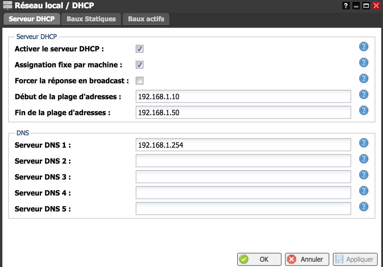

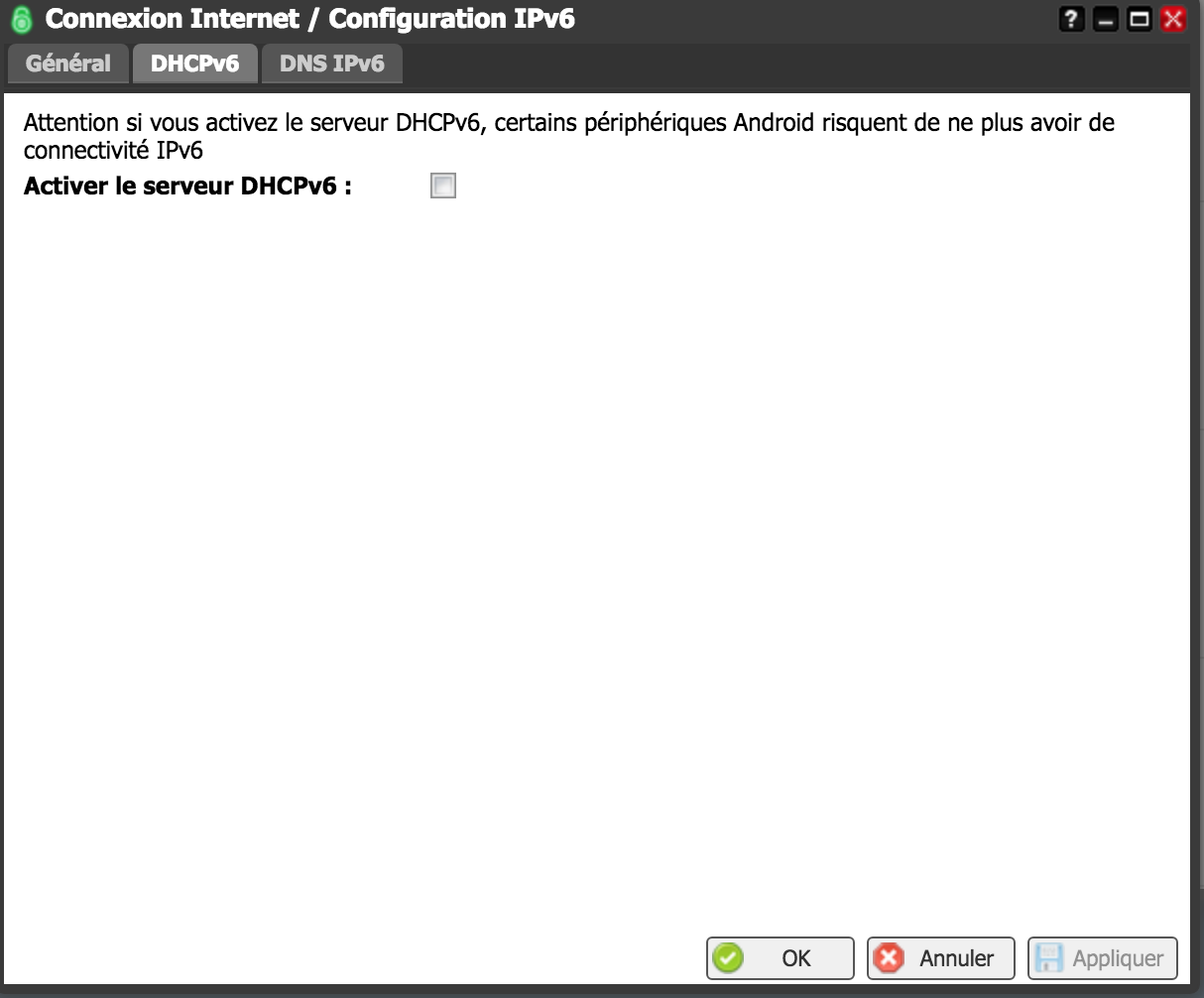

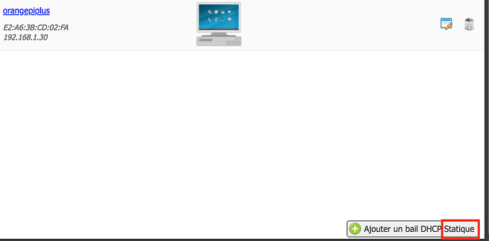

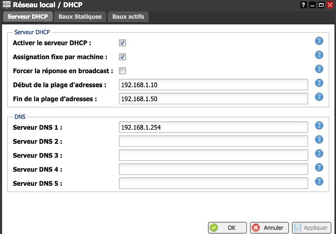

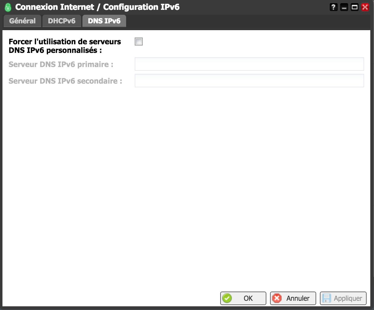

Do you want see my settings in IPv6 settings of my router ?
Edit for security, one pic deleted :confused:
Thanks You!
Yes, that will be helpful

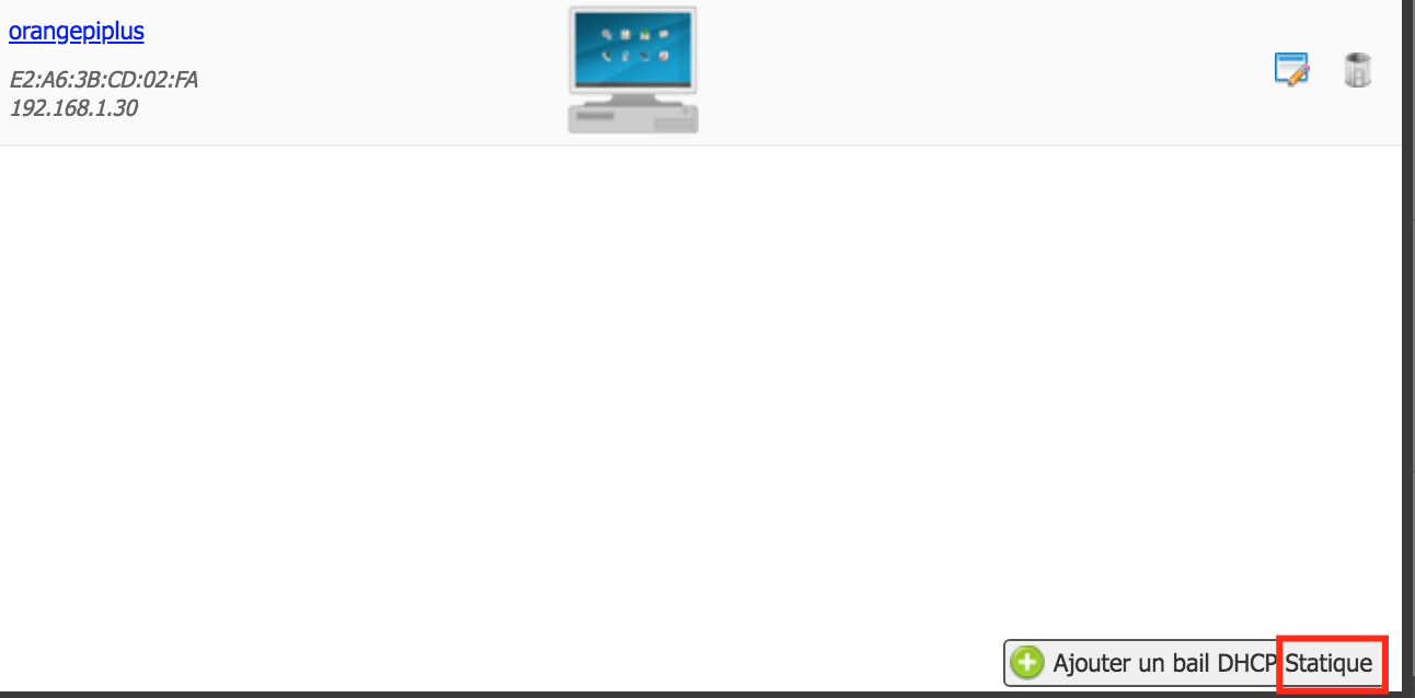

There you go, sorry i don't find any settings of language in router interface :confused:
One Pics deleted for security reason

Some change here :
Test with IPv4 DNS record
ok (0.354s) using ipv4
Test with IPv6 DNS record
bad (0.137s)
Test with Dual Stack DNS record
ok (0.390s) using ipv4
Test for Dual Stack DNS and large packet
ok (0.330s) using ipv4
Test IPv4 without DNS
skipped (0.403s)
Test IPv6 without DNS
skipped (0.201s)
Test IPv6 large packet
bad (0.278s)
Test if your ISP's DNS server uses IPv6
ok (0.419s) using ipv4
Find IPv4 Service Provider
ok (0.462s) using ipv4 ASN 12322
Find IPv6 Service Provider
bad (0.099s)
$ sudo ifconfig eth0 inet6 add 2a01:XXX:XXXX:XXXX::2/64
Edit for security
I have write this line and 10/10 on test-ipv6.com problem solved!
