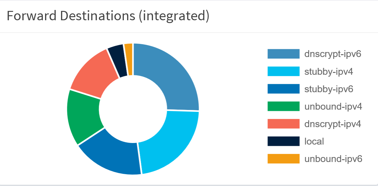

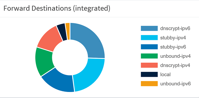

In this topic, I entered a screenshot of the different resolvers behind dnsmasq. As you can see and read, by using the hosts file, the name of each resolver is next to the graph, so I can exactly see witch resolver made dnsmasq happy. That is the goal, don't lose track of it, when proposing solutions!

Result: see the graph above.

@DL6ER When I was testing, to find a working solution, I enabled only one resolver in dnsmasq, this to ensure I wasn't getting DNS responses from another resolver. I noticed the graph changed, even if the resolver did not provide an answer. I could submit hundreds of queries to a non working resolver, yet the percentage for that resolver still increased.
‘edit’
typo's
‘/edit’
Erm, sure, but this is what you would expect, no? After all it is a statistic about to which forward destinations a query got forwarded. It got forwarded to what you configured, even if there was no reply.
Do you think this needs to be changed?
I did expect the graph to show the percentage the resolvers actually responded, but now I know it's the percentage dnsmasq asked the resolver for an answer...
It doesn't really matter, it's statistics only.
It's like this to make the bookkeeping easier:
When we send the query upstream, we know to which forward destination we are currently sending it to :white_check_mark:
Once we receive a reply, dnsmasq doesn't really care from where it comes as long as it matches a previously forwarded query and just forwards the result to the client. So, additional work would have to be invested here to identify the replying forward destination. Albeit possible, I doubt it would be worth the effort as you also already said.
