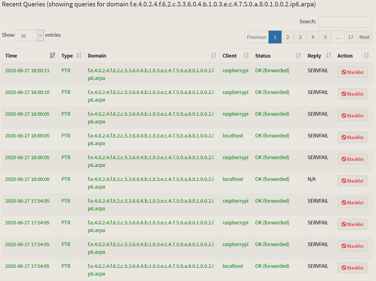

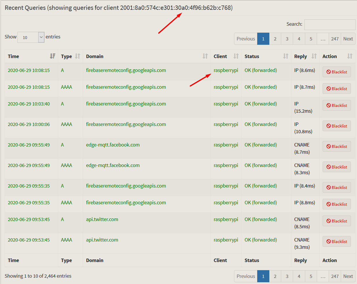

Those are reverse lookups (Type) for a single IPv6 address (Domain) as requested by raspberrypi and localhost (Client) where no hostname was ever returned as an answer (Reply) (terms in brackets refer to your screenshot's respective column).
From the screenshot itself, it is not deducible which device in your network would have that IPv6 address assigned.
Considering your debug log and assuming that your posted excerpt is complete, it can however be concluded that the requested IPv6 does not match your Pi-hole's public IPv6 address, as the latter ends in 4db3 and the former in 04ef.
At the same time, it can be concluded from the respective IPv6 prefixes that those public IPv6 addresses from both your screenshot as well as your debug log belong to your local network.
All in all, this wouldn't constitute an error at all, and it specfically doesn't show that your router and Pi-hole would share the same IP address.
If that doesn't help, please try to rephrase your question.

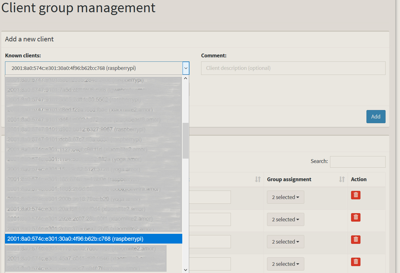

Hi and thank you for your reply.
I've been digging through this for a while now and I'm coming to some conclusions.

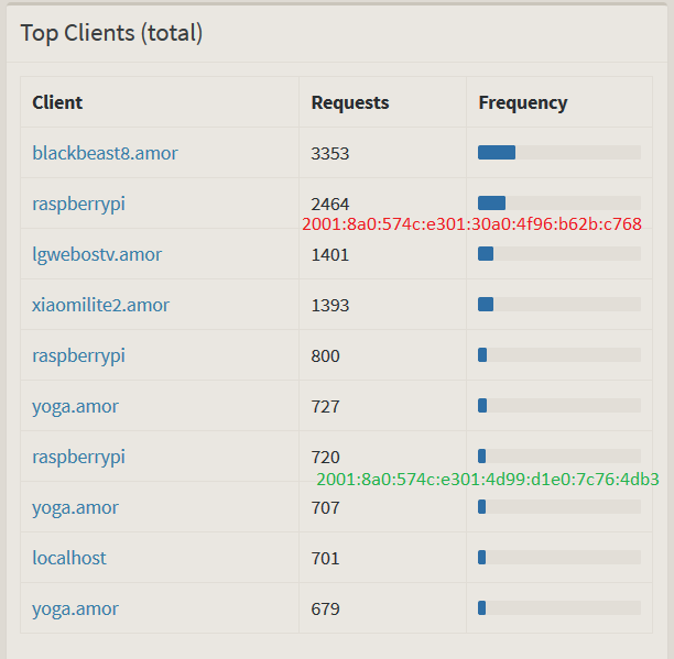

I'm noticing raspberrypi is sharing the same IPv6 address as my mobile phone. I don't know how is this happening.

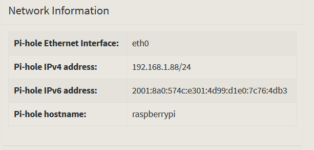

We can see in the pihole_debug attached that the IPv6 is 2001:8a0:574c:e301:4d99:d1e0:7c76:4db3
But on the Clients (also see attached images) it associates another IPv6 to raspberrypi..
How can I fix this?

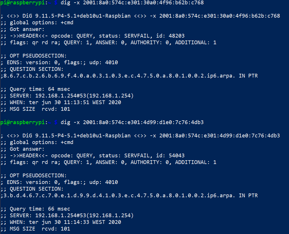

What's the output of the following commands when issued for each of your IPv6 addresses (ending in :4db3 and :c768)?
dig -x <your-ipv6-address-here>
(Replace <your-ipv6-address-here> with the respective full IPv6 address.)
All IPs shown there are also IPs which made requests to your Pi-hole. This is guaranteed. So your IP address may have changed over time. Pi-hole still handles them as different devices as you may very well have two raspberrypi in the same network, right?
No, I have only one raspberrypi.

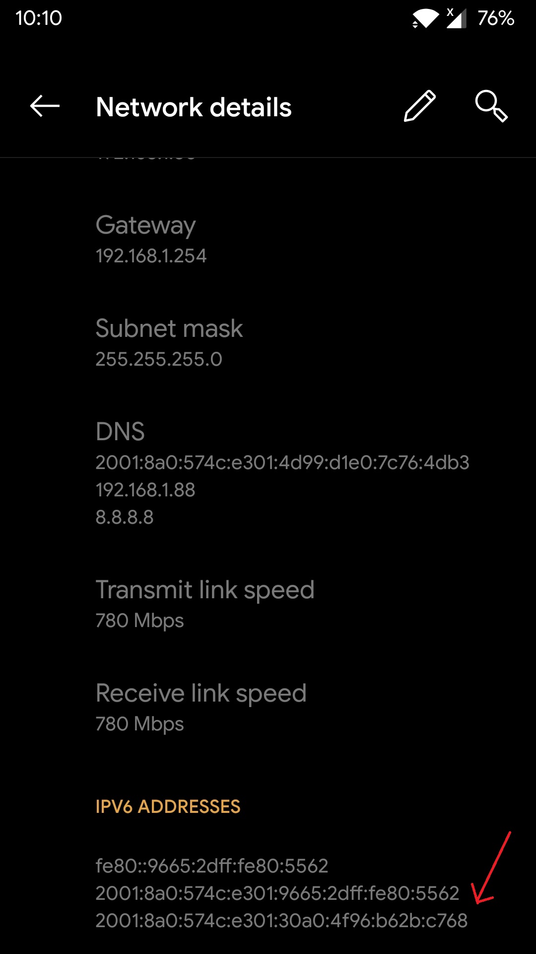

The IPv6 address 2001:8a0:574c:e301:30a0:4f96:b62b:c768 is from my mobile phone wifi 5GHz.
I don't understand why it is being associated with the raspberrypi..
Your output shows that dig was using your router as DNS server.
Please repeat the commands, forcing lookup through your Pi-hole's IP this time:
dig -x <your-ipv6-address-here> @192.168.1.88

I thought about posting the text but it looks off/not formatted for easy reading..
pi@raspberrypi:~ $ dig -x 2001:8a0:574c:e301:30a0:4f96:b62b:c768@192.168.1.88                                                                                                                                                                                                                         ; <<>> DiG 9.11.5-P4-5.1+deb10u1-Raspbian <<>> -x 2001:8a0:574c:e301:30a0:4f96:b62b:c768@192.168.1.88                                              ;; global options: +cmd                                                                                                                            ;; Got answer:                                                                                                                                     ;; ->>HEADER<<- opcode: QUERY, status: NXDOMAIN, id: 46842                                                                                         ;; flags: qr rd ra ad; QUERY: 1, ANSWER: 0, AUTHORITY: 1, ADDITIONAL: 1                                                                                                                                                                                                                               ;; OPT PSEUDOSECTION:                                                                                                                              ; EDNS: version: 0, flags:; udp: 4010                                                                                                              ;; QUESTION SECTION:                                                                                                                               ;88.1.168.2001:8a0:574c:e301:30a0:4f96:b62b:c768\@192.in-addr.arpa. IN PTR                                                                                                                                                                                                                            ;; AUTHORITY SECTION:                                                                                                                              in-addr.arpa.           2391    IN      SOA     b.in-addr-servers.arpa. nstld.iana.org. 2020061019 1800 900 604800 3600                                                                                                                                                                               ;; Query time: 156 msec                                                                                                                            ;; SERVER: 192.168.1.254#53(192.168.1.254)                                                                                                         ;; WHEN: ter jun 30 12:31:55 WEST 2020                                                                                                             ;; MSG SIZE  rcvd: 161
                                                                                                                                                                                                                                                                              pi@raspberrypi:~ $ dig -x 2001:8a0:574c:e301:4d99:d1e0:7c76:4db3@192.168.1.88                                                                                                                                                                                                                         ; <<>> DiG 9.11.5-P4-5.1+deb10u1-Raspbian <<>> -x 2001:8a0:574c:e301:4d99:d1e0:7c76:4db3@192.168.1.88                                              ;; global options: +cmd                                                                                                                            ;; Got answer:                                                                                                                                     ;; ->>HEADER<<- opcode: QUERY, status: NXDOMAIN, id: 40517                                                                                         ;; flags: qr rd ra ad; QUERY: 1, ANSWER: 0, AUTHORITY: 1, ADDITIONAL: 1                                                                                                                                                                                                                               ;; OPT PSEUDOSECTION:                                                                                                                              ; EDNS: version: 0, flags:; udp: 4010                                                                                                              ;; QUESTION SECTION:                                                                                                                               ;88.1.168.2001:8a0:574c:e301:4d99:d1e0:7c76:4db3\@192.in-addr.arpa. IN PTR                                                                                                                                                                                                                            ;; AUTHORITY SECTION:                                                                                                                              in-addr.arpa.           1717    IN      SOA     b.in-addr-servers.arpa. nstld.iana.org. 2020061019 1800 900 604800 3600                                                                                                                                                                               ;; Query time: 212 msec                                                                                                                            ;; SERVER: 192.168.1.254#53(192.168.1.254)                                                                                                         ;; WHEN: ter jun 30 12:35:51 WEST 2020                                                                                                             ;; MSG SIZE  rcvd: 161

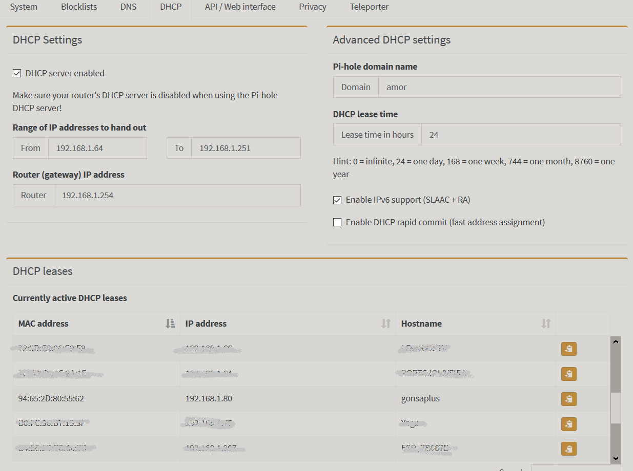

Does your mobile phone appear with a DHCP lease under Settings | DHCP ?
Only the IPv4 of the phone shows up there. Strange.
Is there a way to flush all the leases or restart the DHCP to gather the devices again?

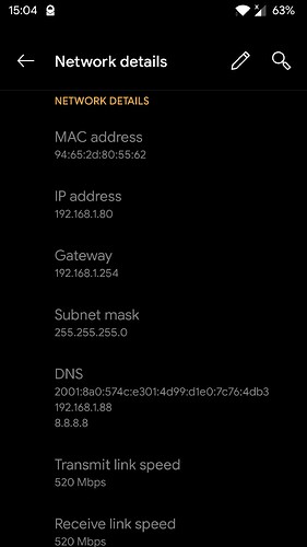

Devices are not at all obliged to request an IPv6 address via DHCPv6. In fact, most won't (Android doesn't even support DHCPv6). Commonly, they will calculate an IPv6 address for themselves, respecting only some information as advertised by the router via RAs (most importantly, the IPv6 prefix),
But if an IPv4 DHCP lease would have been absent for your Smartphone, it could have explained why there is no hostname for your corresponding public IPv6 address.
From your screenshot, I'd expect a reverse lookup to return gonsaplus as hostname.
Does that IPv4 indeed match the IP on your mobile?
Your earlier mobile screen only shows DNS and IPv6 info, not IPv4.
pi@raspberrypi:~ $ host gonsaplus                                                                                                               Host gonsaplus not found: 3(NXDOMAIN)                                                                                                           pi@raspberrypi:~ $ host 192.168.1.80                                                                                                            Host 80.1.168.192.in-addr.arpa. not found: 3(NXDOMAIN)
And in a screenshot a few posts above you can see the IPv6 address of the phone.

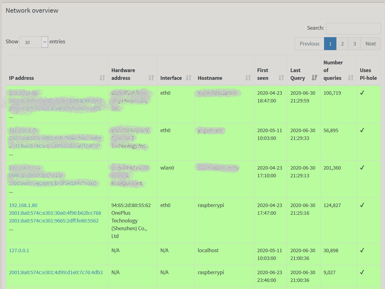

@ Bucking_Horn I found this:
This is where it is associating the IP 192.168.1.80 to raspberrypi, although as we know the real one is 192.168.1.88.
How can I fix this? Can I flush these entries?
So I pressed the Flush Network Table in the settings, it wiped all these entries but put back the IP ending in 80 as raspberrypi...
This confirms that :c767 and .80 are related to the same device.
It shows the same unwanted and yet unexplainable association of raspberrypi with those addresses.
