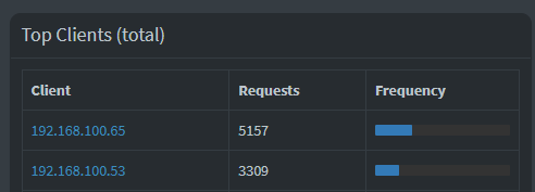

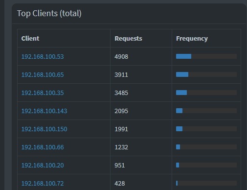

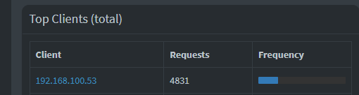

IP addresses in dashboard instead of client names
Hello,
I have Pi-hole installed pretty standard, except for using Apache webserver instead of lighthttpd.
My issue is that Pi-Hole is my DHCP server, and under the DHCP section i can see my leases correctly, MAC | IP | Hostname.
However, in the dashboard, only the IP's of the clients are shown, the only ones with names are ones i have created manual CNAMEs in Pi-Hole for.
From what i have read, Pi-Hole being the DHCP server, and showing the correct names in the dhcp.leases file, it should be correlating it for the dashboard.
