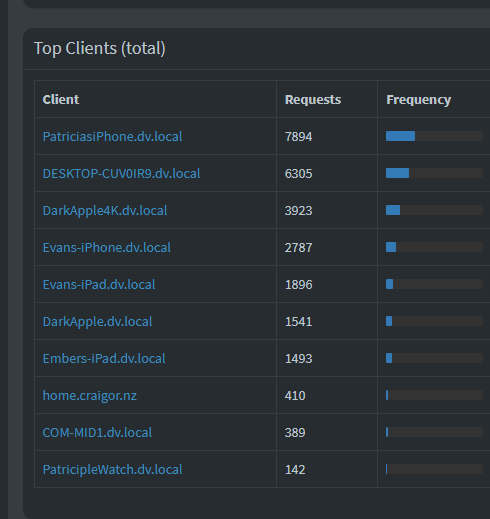

DNS resolution is working fine, always has, its just purely the webpage not showing the name over the client IP.

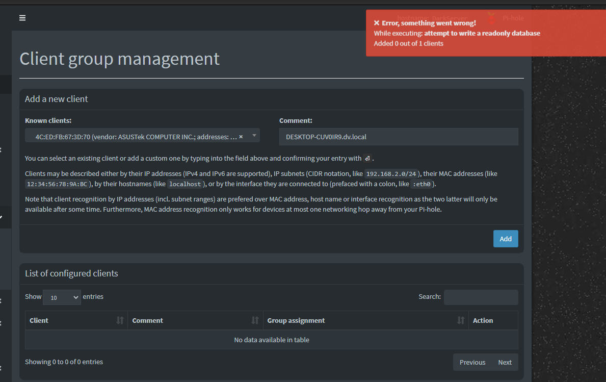

However, i just tried to use group management > clients to add a direct name for my PC and i got the following error

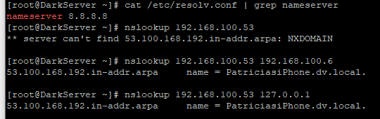

So i assume this is the core of my issue, on startup it checks the dhcp clients against itself, and the query doesn't actually make it to FTL by the looks, it then records in its database the names to be used by the webclient.
I just ran this test, nslookup 192.168.100.53 from the server itself.
Both the localhost and ipv4 address resolve the name, but obviously google dns doesnt.
Not sure why this doesnt occur on startup

[root@DarkServer log]# nslookup 192.168.100.40 192.168.100.6
40.100.168.192.in-addr.arpa name = Evans-iPad.dv.local.
[root@DarkServer log]# nslookup 192.168.100.40 127.0.0.1
It almost seems as if there would be another DNS server snatching those requests to the loopback address before Pi-hole sees them. :thinking:
Your ss output suggests you are running systemd's stub resolver alongside Pi-hole on a different port (5355).
What's the intention of having that running in addition to Pi-hole?
And even though it is reported as listening on a different port:
Could you try to verify if it would be involved by trying to stop and disable systemd-resolve?
You win the prize.
So, it looks like even though pihole takes over the localhost resolver on port 53 on startup, it either takes long enough that the other resolver still responds, or it processes the dhcp devices before it takes over ownership of that port.
But it is all working now, thank you for the ongoing help instead of giving up.
This can safely be ruled out as we see in your logs that it "gives up" after only 30 msec.
What you found is really puzzling. I don't see how a query to 127.0.0.1:53 can end up somewhere else. I (and many more) run unbound on the same machine on 127.0.0.1:5353 and we never had any report about something similar.
