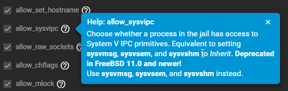

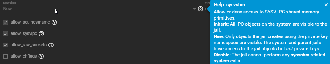

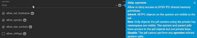

Doesn't seem to be, I've added more checkboxes in two steps and retested:
Screenshot1
Screenshot2
What is most obvious and definitely problematic here is
FATAL: create_shm(): Failed to create shared memory object "FTL-lock": Function not implemented
This means that your kernel may have been built without CONFIG_SYSVIPC. Related kernel documentation:

As Posting screenshots on snipboard.io isn't allowed (or gets my postings flagged as spam) I'll add it as text: There's an overlay help menu at allow_sysvipc ->
help allow_sysvipc
Choose whether a process in the jail has access to System V IPC primitives. Equivalent to setting sysvmsg , sysvsem , and sysvshm to Inherit . Deprecated in FreeBSD 11.0 and newer!
Use sysvmsg , sysvsem , and sysvshm instead.

Screenshot from 2023-04-19 22-42-21
So sysvshm will by your friend.
LOL, seems I don't use discourse often enough...
There's an option for that, but it's already at a good setting...
I'ld say I'll take it from here to the TrueNAS Forum... Except you guys say let's push the FreeBSD build, for when I'm happy to test with FreeBSD Jail's or VM's on my ProxMox Cluster... :wink:
As long as there is no working support for shared memory, there won't be any chance for whatever a "FreeBSD build" would turn out to be in the end.
