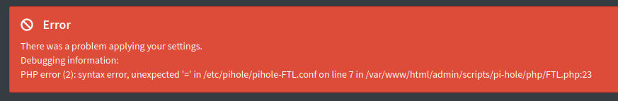

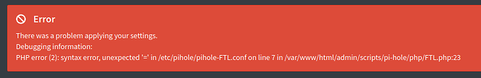

When I add FTLCONF_DBFILE=, the resulting pihole-FTL.conf is:
#; Pi-hole FTL config file
#; Comments should start with #; to avoid issues with PHP and bash reading this file
PRIVACYLEVEL=0
LOCAL_IPV4=192.168.2.10
REPLY_ADDR4=192.168.2.10
RATE_LIMIT=1000/60
declare=-x FTLCONF_DBFILE=""
And I got this error in the frontend:
To fix this, I had to mount the volume and edit the file manually.

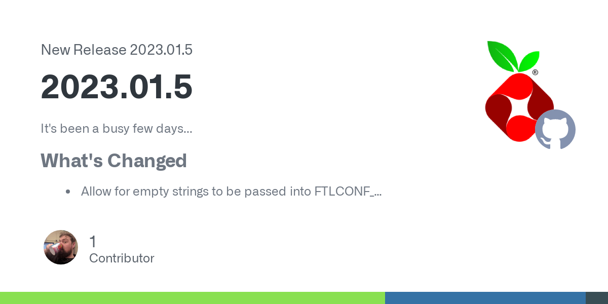

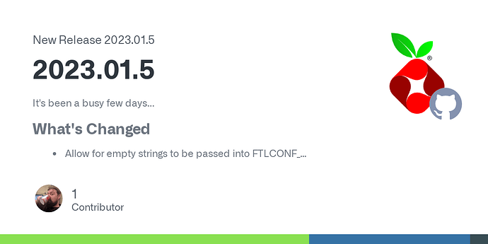

@PolDellaiera I located the bug in the docker startup script and have fixed it for the next version...:
Give it about 10 minutes or so and it will be built.. (follow along here if you're desperate!) let me know if it works for you or not.
From that version on you should™ be able to set FTLCONF_DBFILE="" and it will be parsed correctly.

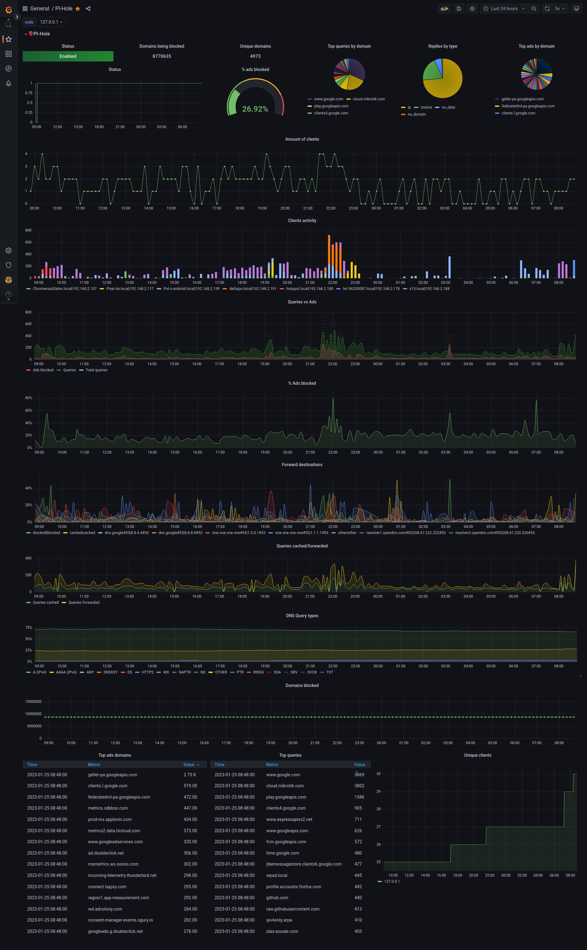

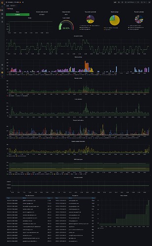

I've been playing a lot with PiHole and Grafana... and I succeeded to make a cool dashboard with the existing PiHole API.
The thing is that to do that, I had to use specific Grafana functions (delta), to compute the changes between the current data and the previous one.
