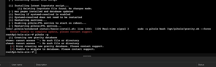

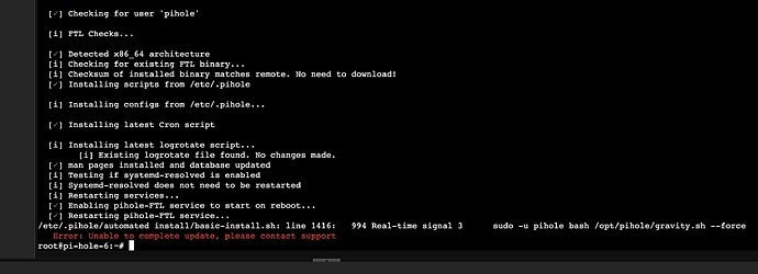

I tried this last night and it worked. In Proxmox I cloned my running Pi 5 and did all three upgrade steps as per your documentation. Worked fine, but I missed the part about the 8080!!! :frowning: So I deleted everything.
Tried again today and it does not work. Something changed overnight. Please see screenshot....

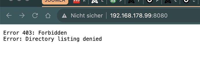

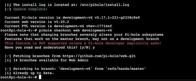

I installed a brand new version of Pi5 and then "pihole checkout core development-v6" without a hitch. Frontend still shows. After "pihole checkout web development-v6" I try to load P6 with :8080 and I get a "Directory listing denied".
Access the web interface with
192.168.178.99:8080/admin
Thank you yubiuser, that fixed it. Not mentioned in the docs, or not so that I could understand it.

Okay, I thought your issue was already solved. Just to make this crystal clear: You have installed a brand-new v5 and were able to upgrade it to v6 just fine. But you also tried upgrading an existing (different!) v5 installation and there you consistently saw the
/etc/.pihole/automated install/basic-install.sh: line 1416: 994 Real-time signal 3
preventing the upgrade from succeeding. Is this correct?
Exactly.
I am running this on Proxmox and cloned the working Pi5 container. The upgrade consistency fails as per the screen shot. Fresh Pi6 install worked without a problem!!!

Thanks for the offer, I have been thinking this through but it is actually kinda tough. Even more because we don't get the exact line where this happens, we just know
is failing somehow. The last change to the gravity.sh was back in October, so there is also no recent change. You see I'm noting down my thoughts in almost chaotic order here, partially hoping that someone will read through them and say: Dang! I have an idea.
Well, let's just continue thinking here. What we could try is to run pihole -g in the container right after you have seen the error message above. It will be interesting to see if this fails as well, and if, how, or if this works just fine.

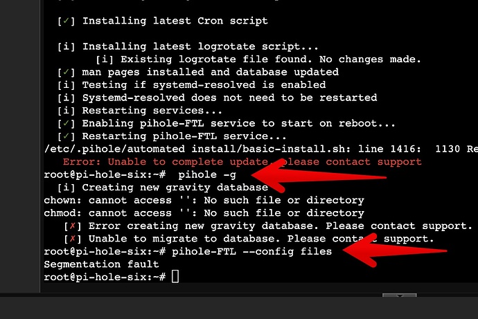

Nope, not working....
Hope this helps!!!
This is indeed helpful - even it not very much - it is a good start!
So the error most likely happens here:
indicating we have a problem with
and
What is the output when you run
pihole-FTL --config files
The code is like Chinese for me.... :wink: But with your guidance I can just run the code you need...

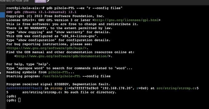

Great! I mean ... "Segmentation fault" is surely not great but we found the root cause. Could you follow the steps under " Prerequirements (only required once)" at Redirecting... ?
Once done, please run
gdb pihole-FTL --ex "r --config files"
and when it then crashes please enter
where
and provide another screenshot. This may already be what we need fix the bug.

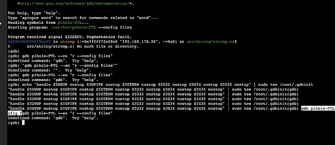

Not sure I did it right, this is what I get. Don't understand the "screen" command... :frowning:
Sorry, but I really do not know what I am doing....

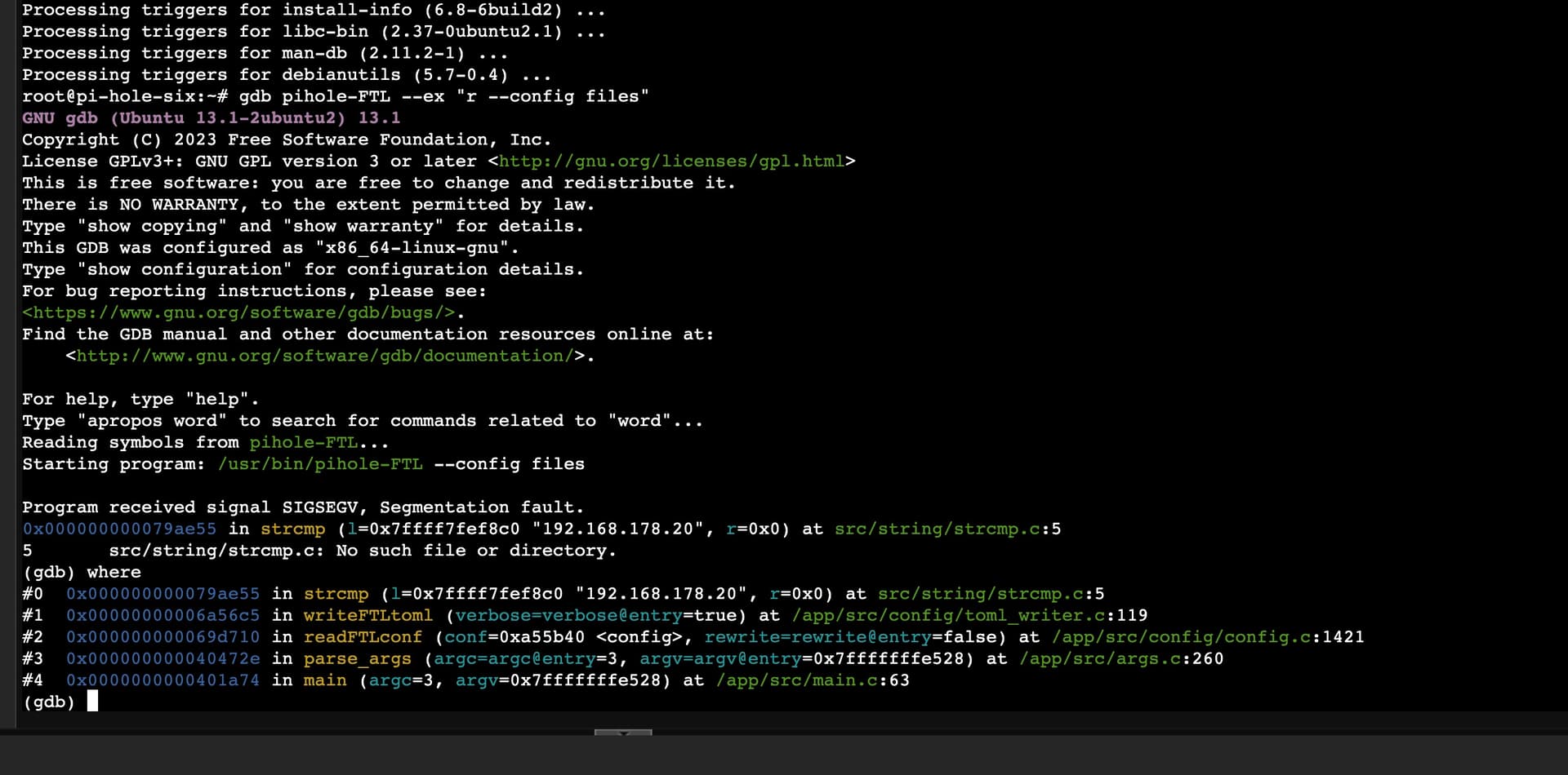

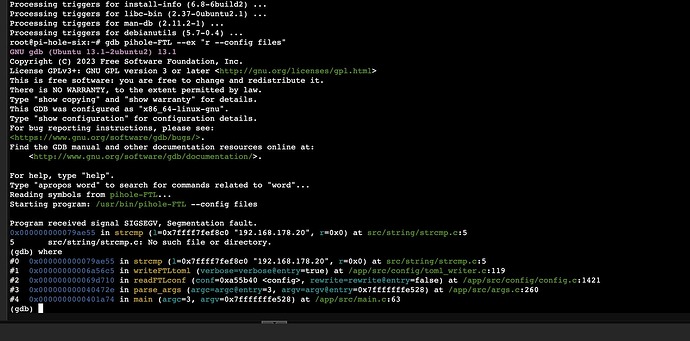

Type: where
This looks better, I guess....
