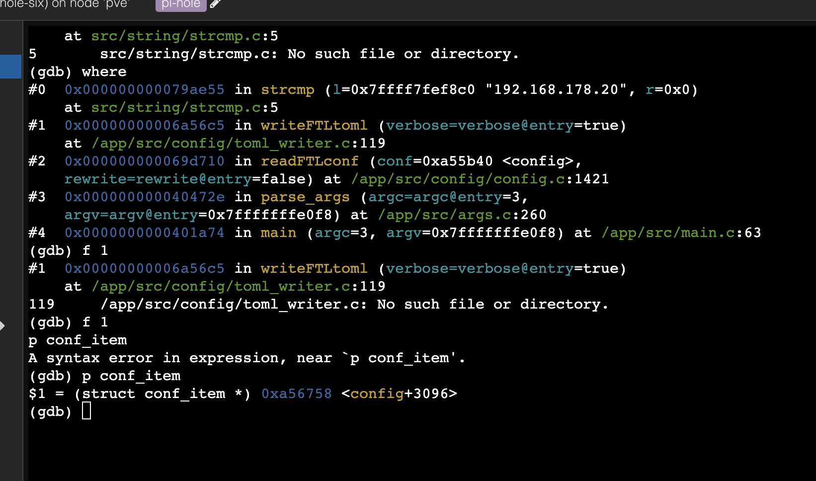

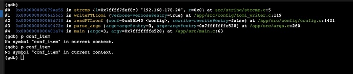

Thanks, this is perfect! This is already sufficient to fix it but I'd to understand where it comes from. Please also enter
p conf_item
and show us the result

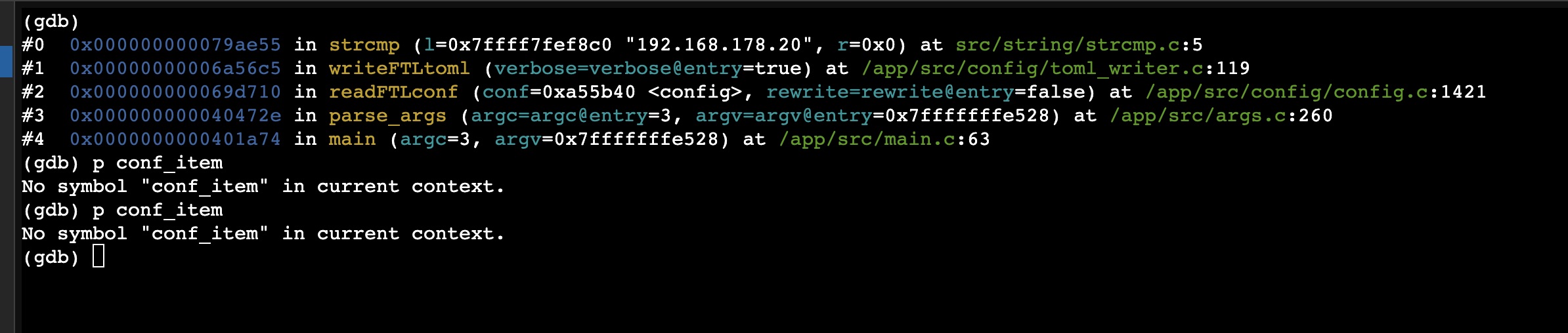

This does nothing.... (Late in Germany, going off-line now. Will gladly try stuff tomorrow again!!)

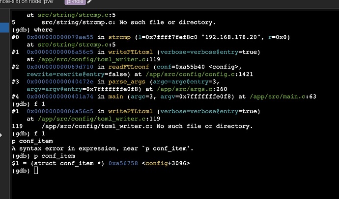

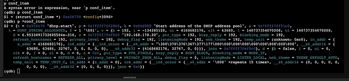

Ah, yeah, I forgot you will need to do switch frame to the relevant one first, like:
f 1
p conf_item
See you tomorrow.
Of to bed....

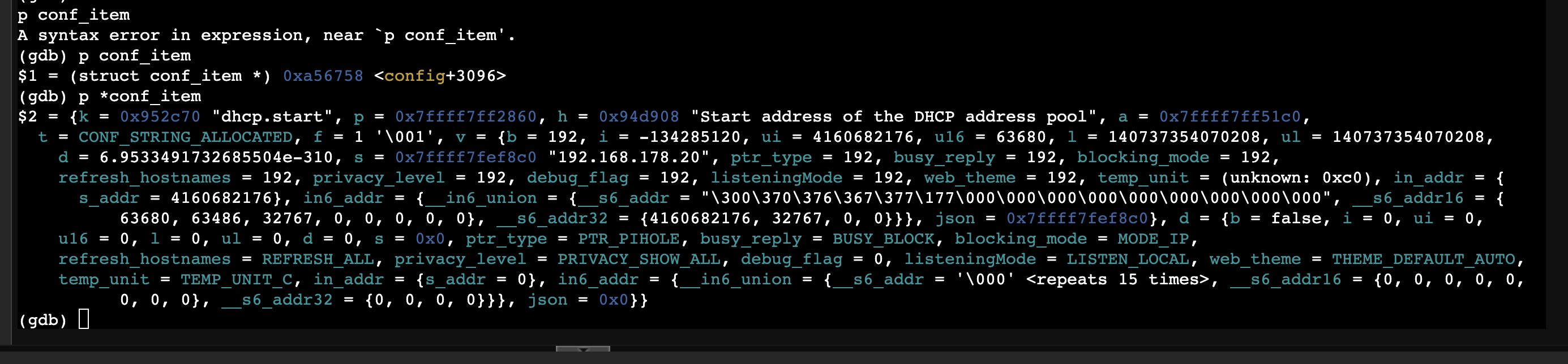

Sorry ... we will also need
p *conf_item
after the others...
Hey, no problem. I am very happy to give back!!! You just have to have a little patience, I am 67 and not firm (understatement of the year!!) with this stuff. I am giving my best and as long as I can help, ask away!!!!
Thanks indeed very much for your help, without it it'd have been close to impossible to find this regression.
The bugfix is here and technical details are therein:
As soon as this is merged, there should be no crashes and more and, furthermore, similar crashes are avoided by construction in the future. Thank you for helping up making Pi-hole better for everyone!

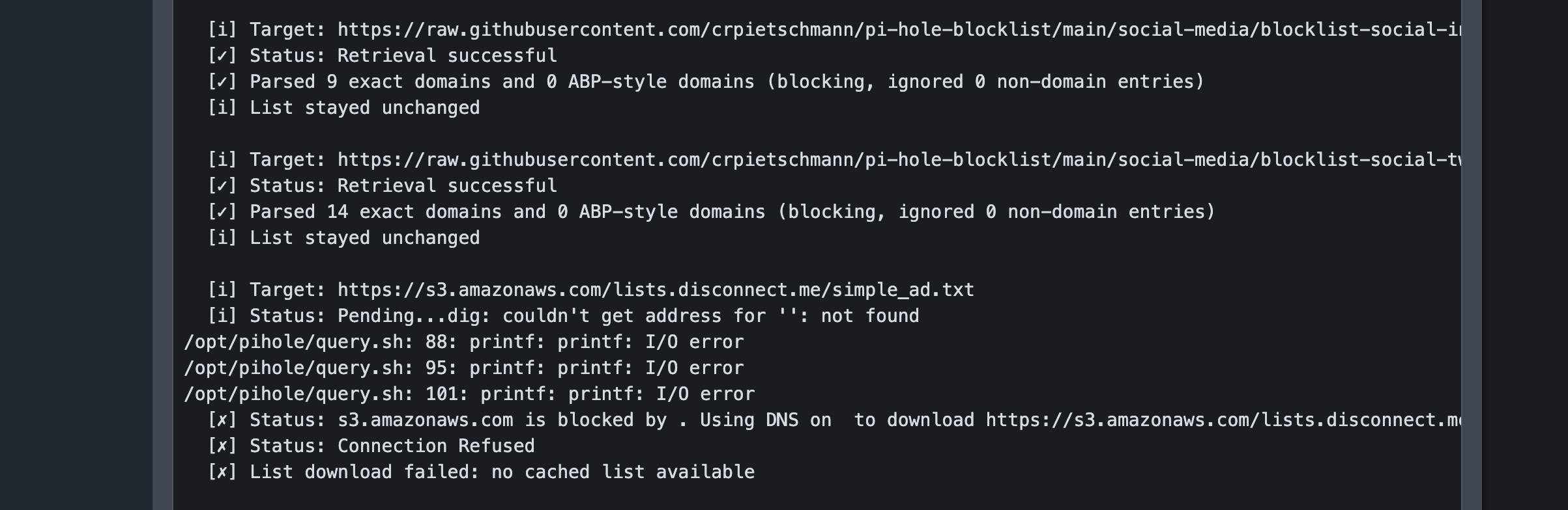

This list is updated in PI5 no problem, PI6 throws an error....
