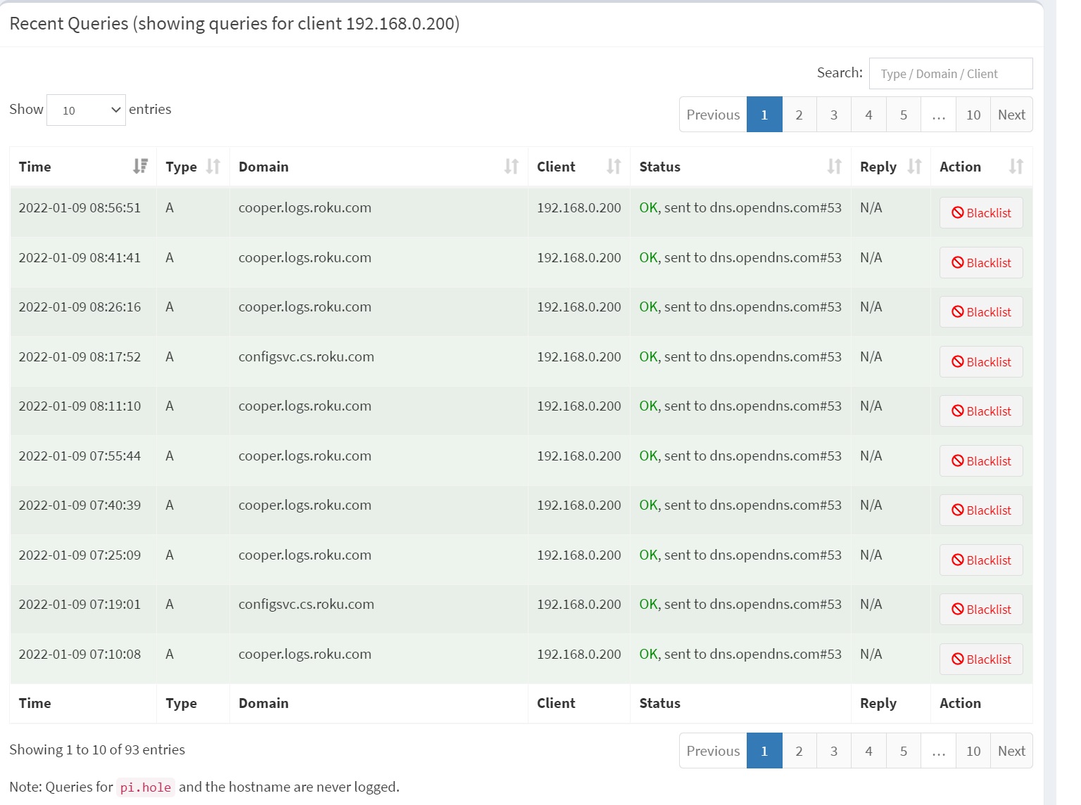

This is interesting, are there other queries from this host being accepted? This may point to a bug in the analysis of the dropped peer's address. This is still a feature undergoing testing.

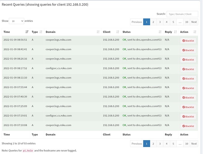

Hi DL6ER,
At the moment (it's 1117am) the last time Pi-Hole shows any log for this device (via http://192.168.0.2/admin/queries.php?client=192.168.0.200 ) was at 0856am. Despite the fact that I've rebooted it and tried to use it (it's a roku-stick, wireless). The roku-stick appears to be working as normal.
I've uploaded an image of the log
Regards, Jeff

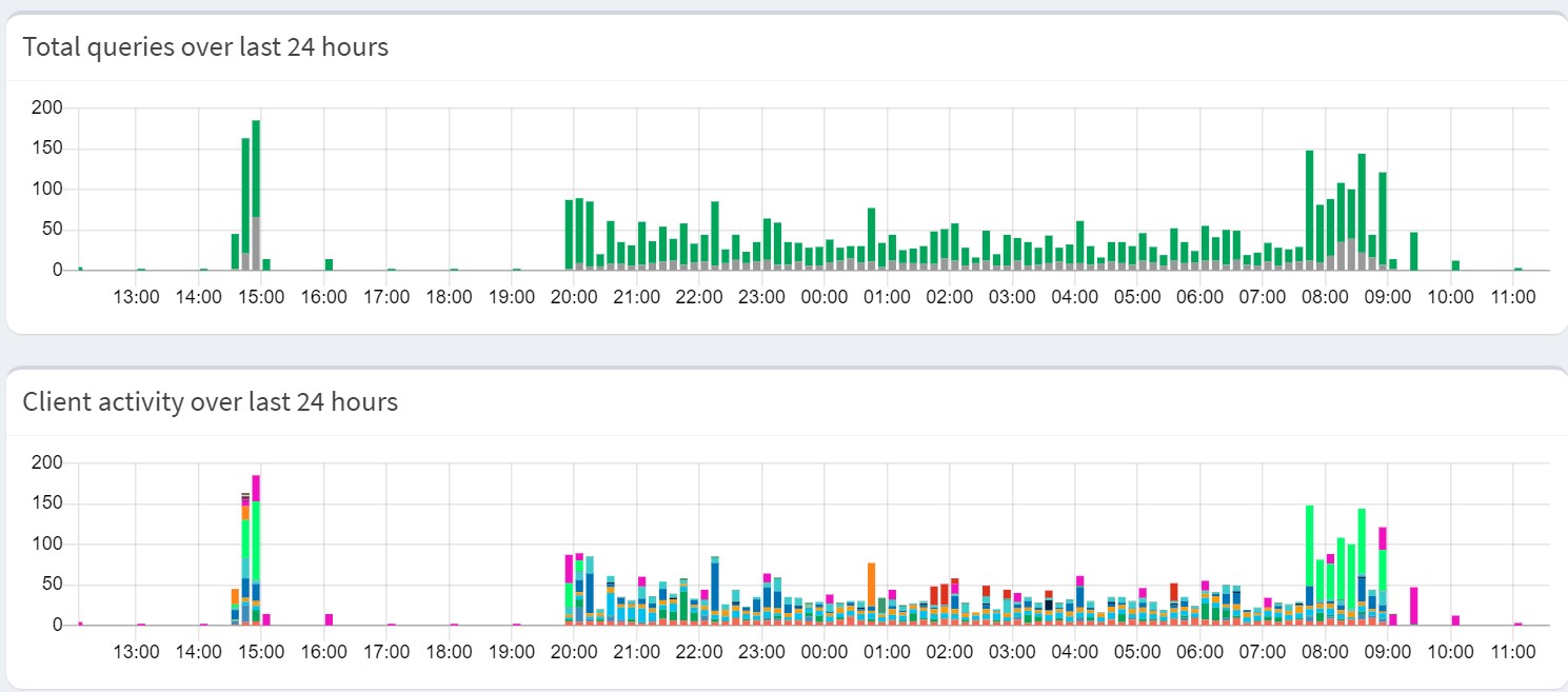

I should also add an image of the Dashboard where it shows that very little traffic seems to be going through the PiHole at the moment, and at previous times.

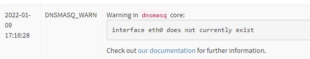

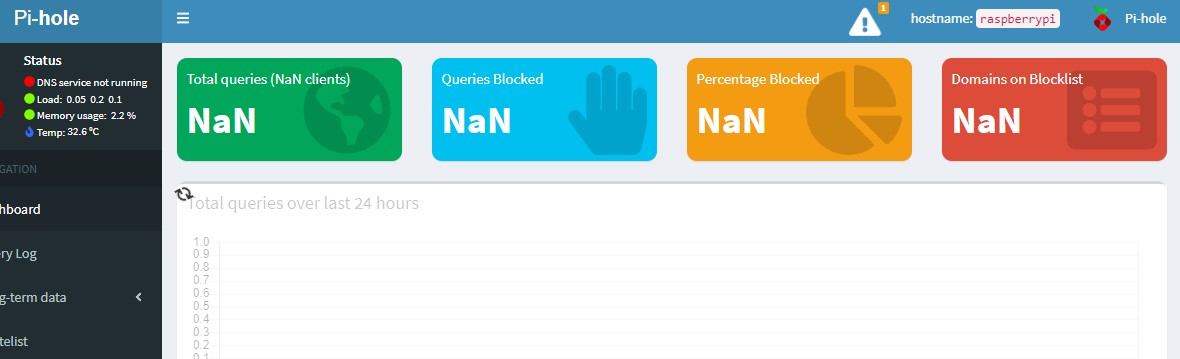

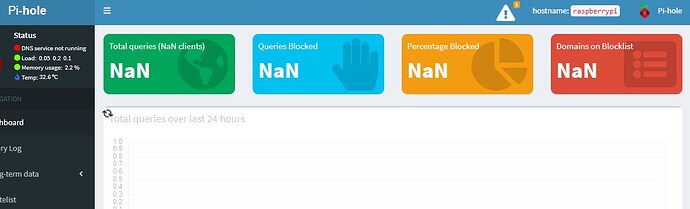

If I change to 'Bind only to interface eth0' then the dashboard shows NaN in all the boxes at the top
If I set DNS to 'Respond only on interface eth0' Then the dashboard looks normal. But I do get
and the Pihole chronometer shows P-hole offline.

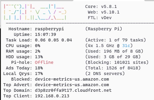

It's Monday and I'm back at work (as perhaps are you) and thus have less time to work on this but I wanted to let you know that I did deactivate the WiFi (via sudo ifconfig wlan0 down) and (as previously mentioned) set the PiHole DNS to 'Respond only on interface eth0'. The PiHole appears to be working from the GUI but the PiHole -Chronometer shows the PiHole to be offline.
I find it odd that PiHole is having trouble with there being two network interfaces given that it's running on a Raspberry Pi which comes with two network interfaces! (three if you include BlueTooth).
Best Regards,
Jeff
This is a known bug and is being addressed:
I'd like to close this topic now with a thankyou to all who helped and an attempt at a summary.
PiHole is working again without generating that 'Ignoring query from non-local network' message. The modification pihole checkout ftl new/non_local_details was helpful in showing the IP address that generated the message. It was a wifi device on the same network as everything else!
I have, on my Raspberry Pi, both the Ethernet and Wifi connected to the same network. On the DNS tab of the Settings page I have changed from the default to Respond only on interface eth0. I temporarily disabled the WiFi (with sudo ifconfig wlan0 down) but that didn't seem to make any difference.
I am now awaiting the fix to PiHole -chronometer. If I was more impatient I would apply the fix, but I'll wait for the official fix to come through as part of the build (probably using the wrong terms as I know nothing about Github).
