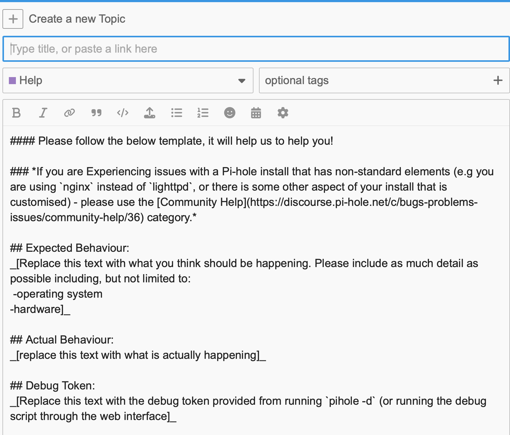

Per our help template, please generate a debug log, upload the log when prompted and post the token URL here.
Are you referring to the templet when the support request is created:
- Pi-hole version: [version number]
- Router model: [model name]
- Affected devices: [device types]
- Specific website that is not being blocked: [website URL]
What I've tried:
- Verifying DNS settings on devices are set to point to Pi-hole
- Clearing browser cache and cookies
- Checking the blocklist for the website

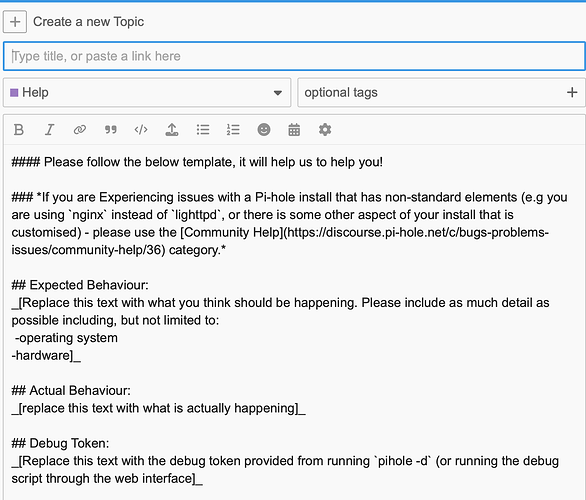

I'm referring to the last lines in the help template:
Here is the Token
https://discourse.pi-hole.net
