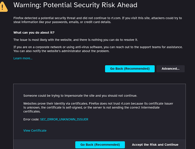

my current setup is pihole + unbound, but because of recent wars i get to see the ugly face of censorship so i cannot access rt.com, the ISP is hijacking the connection and the certificate
what are my options? Remove unbound and switch to DOH?
That may work. Try it and see. If you encrypt your DNS to an upstream server, your ISP can't see or tamper with the queries. But, they are free to block the IP if they are intent on censorship.

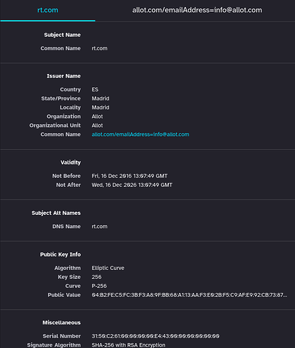

Have you viewed the certificate to see what problems are shown?
thats the certificate
Thats indeed not the cert for rt.com:

And below one run on the client from which you got the cert info screenshot?
C:\>nslookup rt.com
Server:  ph5a.home.dehakkelaar.nl
Address:  10.0.0.2
Non-authoritative answer:
Address:  91.215.41.4

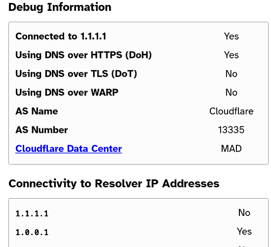

enabling DOH on firefox https://1.0.0.1/help returns
yes 1.1.1.1 is blocked
On topic again, sounds like some big nasty firewall redirecting traffic to a host with the wrong cert.
SNI, used during the initial SSL/TLS handshake can be sniffed easily and filtered so VPN or Tor comes to mind as a solution.
Or if you use browsers, enable the DoH option.
EDIT: our postings crossed paths :wink:
1 rt.com is not accessible even if DOH is active on firefox
2 tor works
